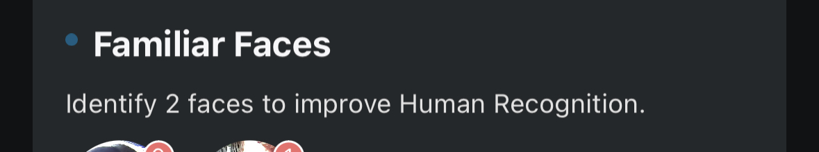

I just got the homebase3 but only have the T8210 connected (not the dual camera). That combination should work, or?
Haven’t had too much time to play around with the eufy-app yet (just seen that all cameras have been able to see a face and name the face).
When I try and use the “person detected” card I’m not able to say which person (I’m not allowed to write any name).
@Stjepan_Siljac
Yes that combination should work. I would suggest restarting the app theres a small issue with events after pairing.
And also make sure that you push notifications are enabled
Like this:
ezgif.com-video-to-gif
For support the Homey app adds a lot of functionality which the official app cant do. So almost everything should be supported :wink:
Hi.
Everything is enabled and rebooted but I’m still not able to add persons…
@Stjepan_Siljac did you add the persons in the official app?
Thats not something you can do in Homey unfortunately
There are two face that I’ve been training on today and managed to get set to “familiar faces”
Hmm
Can you enforce some person detection…like standing in front of the camera and send a new report after that? Then i’ll check the logs
Will do that tomorrow :sleeping:
