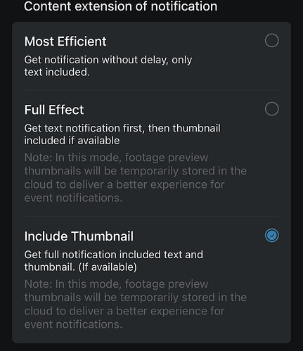

Old snapshots from EufyCam 2 too:
As seen by Eufy mobile:
As what Homey app gets:
Notification is set as:
