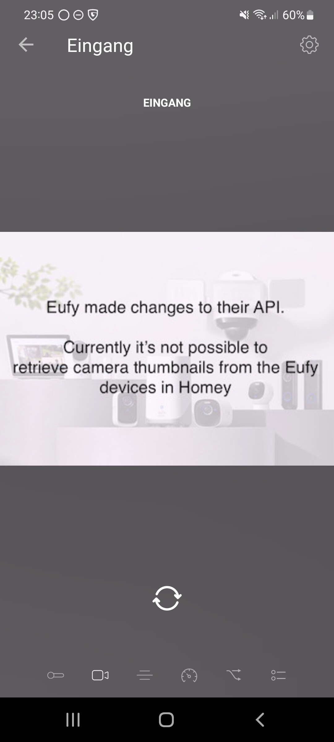

Hey i have some problems with my indoor pan cameras. I hope you can help me.The Stream side shows all the time that the api from eufy had changed.
