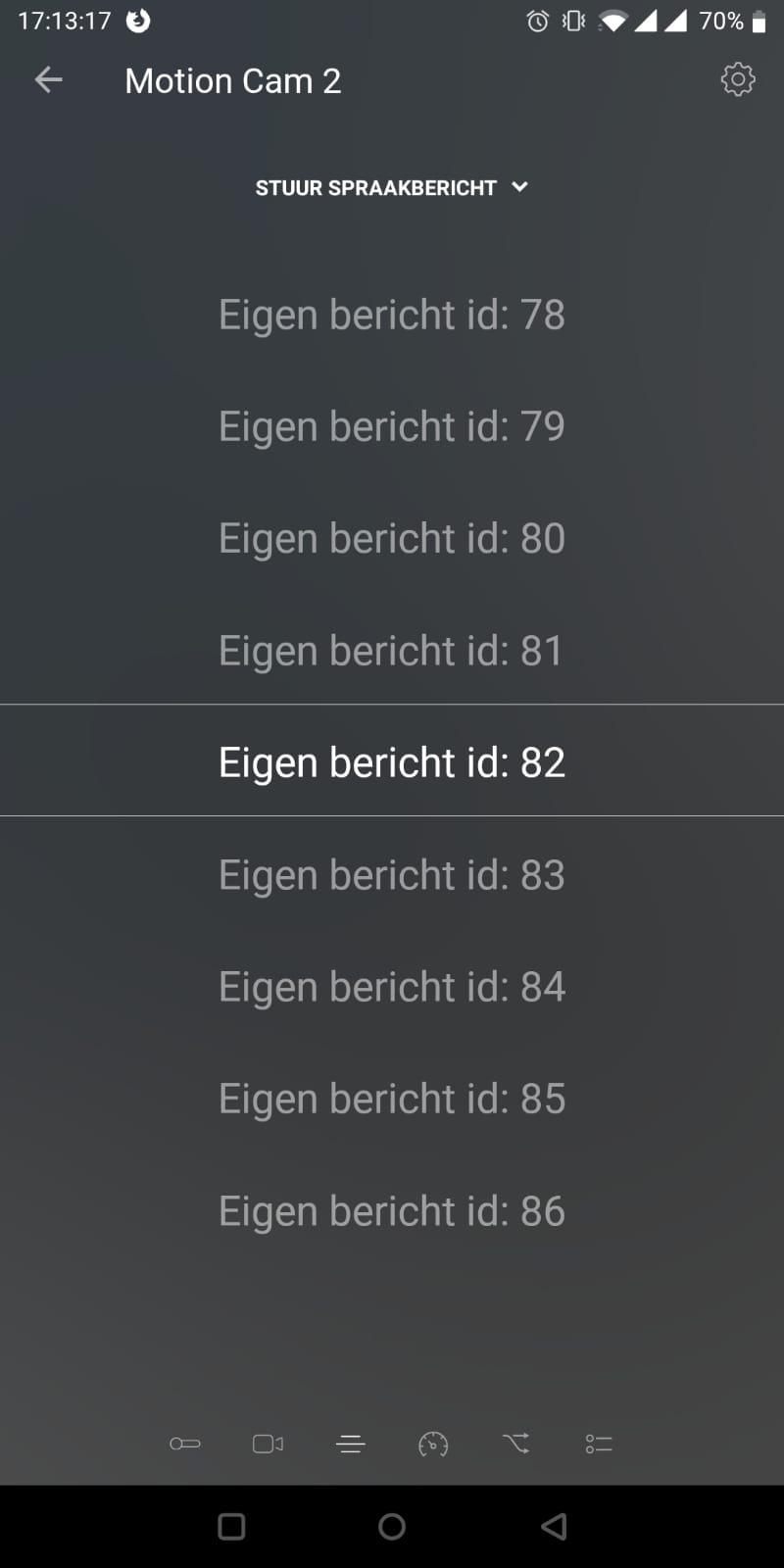

Updated the test version of the app v1.8.19 and added the quick menu again. Also added 100 quick responses in there. :see_no_evil:
Maybe in that way we can find the related indexes for the custom responses.
Did some research and also tried to debug the apk of Eufy but I can only find the command but not what the value should be.
For example setting guard_mode uses value 63. So might be the same for quick_responses

@martijnpoppen i Just scrolled through all of them, nothing is played back. Do i still need motion?
Yeah you still need motion. 1,2 and 3 give standard reactions. I can’t find personal messages. Tried all 99.
Strange, i was in front of the doorbell when i tested, the ring is glowing, and i get a thumbnail sent to the eufy app. But nothing is played back
@2Be wow. ok didn’t expect that.
I’m not even sure if it’s possible. I would say so. I’ll try some other things.
Really hoped one of these indexes would do the trick…
U have to push the option after scrolling to it. Maybe you just scrolled?
@martijnpoppen I hope others will try all the options too. There are many and I guess I tried all of them, but as the standard messages show you need stuff like motion too. I tried being in motion all the time and pressing the doorbell to keep the connection alive. Maybe others have more luck. Will try again tomorrow now starting from 99 downwards.
