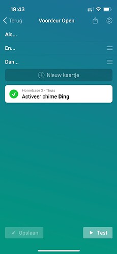

@Quaasteniet can you share your flow?
A very basic example

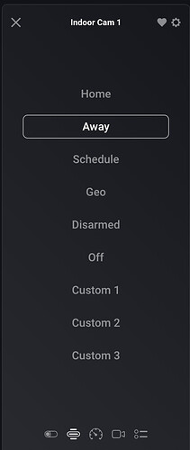

@Dyan_dh
Hey
so you mean this one?
Every stand-alone camera should have it. (unless connected to Homebase 3)
and the Homebase has this option
