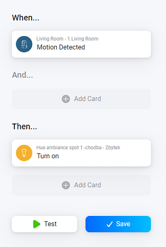

I have really basic flow:
After update I can not see any device in any account…:slight_smile:

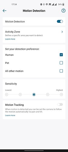

@Jan_Vitasek do you have motion detection enabled. Or only person detection?
Your notifications are working. I see Human detections coming in
Theres a specificPerson detected flow card in Homey for that

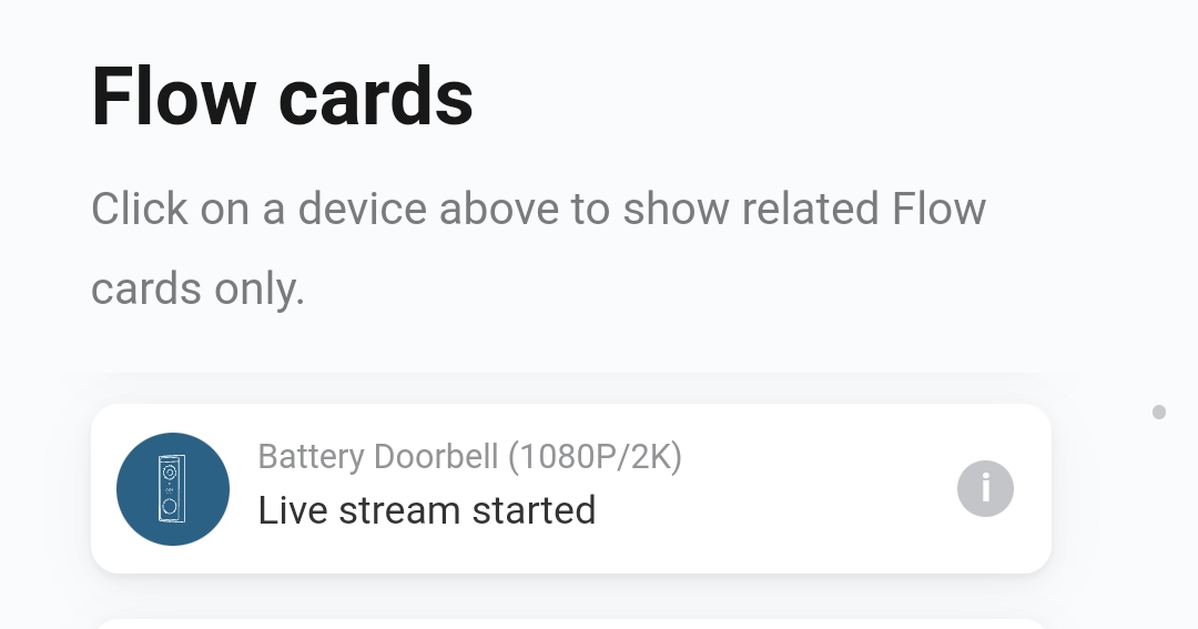

@martijnpoppen I understand, maybe also a nice to have, that you can wait on the start live stream for the advanced flows and you return the stream url (when available)
@DominicVonk that card already exists :smiley:
@martijnpoppen I know, but also as direct response for the action card, so the flow will not be splitted
Ah like that. Hmm it will timeout on Homey. So thats really error sensitive. Next to that its not possible to add a token to a action card :confused:

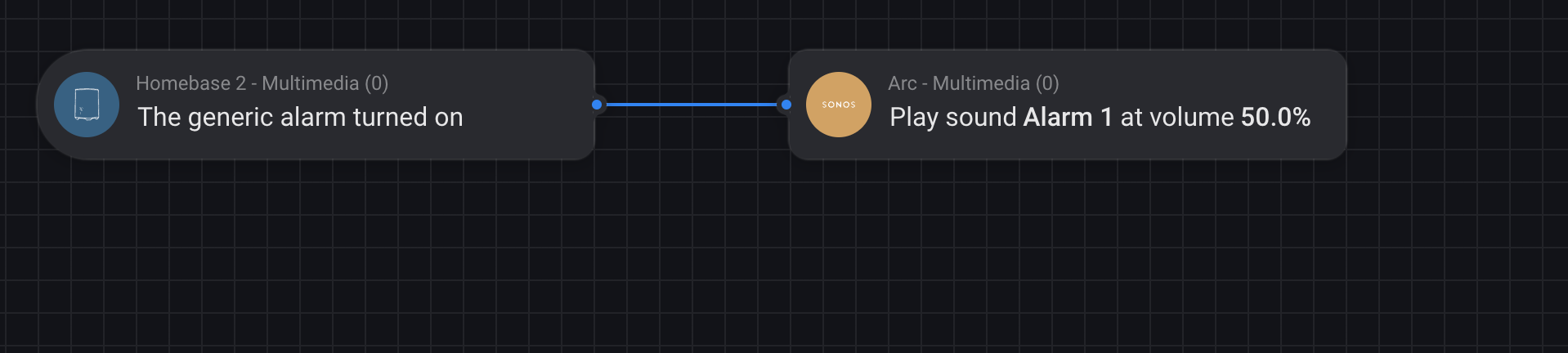

I want to create some flows with Eufy security and Sonos:
When the Eufy alarm is active and the doorsensor shows a trigger, sonos play a alarm sound.
The alarm volume from the homebase is very low, I want to increase it. At the moment the alarm sound don’t reach the first floor.
If it’s possible, how do I set this up?
Thanks in advance!
After some tries it is finally working!
Thank you.
Yes I have it like this
@Robin_Groeneveld You can do it like this:
Thanks, in this case it works {Flow; if Homebase - than Sonos}
