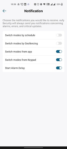

Hey @homeypro
Can you check your Homebase notifications?
Make sure these are on:
Theres an in issue with setting those settings from Homey at the moment
Due to a bug in Eufy the settings are reset every now and then. Thats why i made a option to force them. Somehow that force option got broken.
Can you also send me a diagnostic report?
