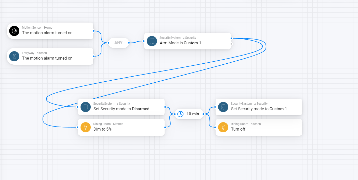

Cool - I think I can just do it with the Eufy base like this
Yes that should work.
When dog wakes us up at 0400 and the alarm is on, we dont want it to go off when the door opens, so the camera can see us in the house, it turns off alarm for 10 minutes and turns on the light… I am using this same process for arming / disarming at night and in the morning.
