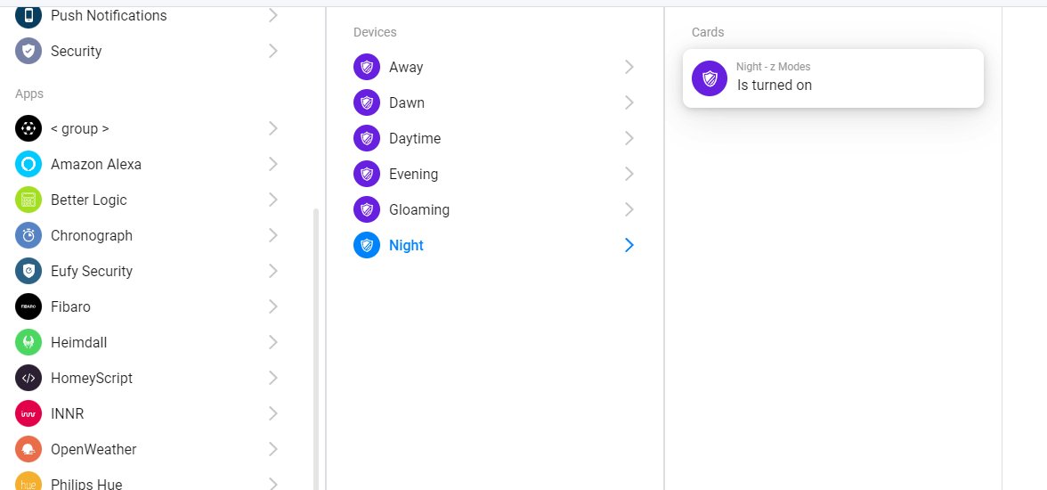

I have anoth annoying flow question I seem to be getting very wrong.
Context, I am trying to create a deterant in my back garden using floodlight cam 2, when motion detected and the house mode is night, do something…
Problem is, I do not know what to start with becuase each when
action gives me more options. So, a virtual device as the trigger can be ā€œmode onā€ but when it is the AND it only gives me ā€œis turned onā€
So, the same thing happens in reverse, with the Eufy Cam, becuase if I allow that to be the AND it only allows me to choose ā€œthe motion alarm is onā€ - which doesnt work either.
I feel ashamed to say I think i am missing something very basic here! It feels like I need both to be when actions?

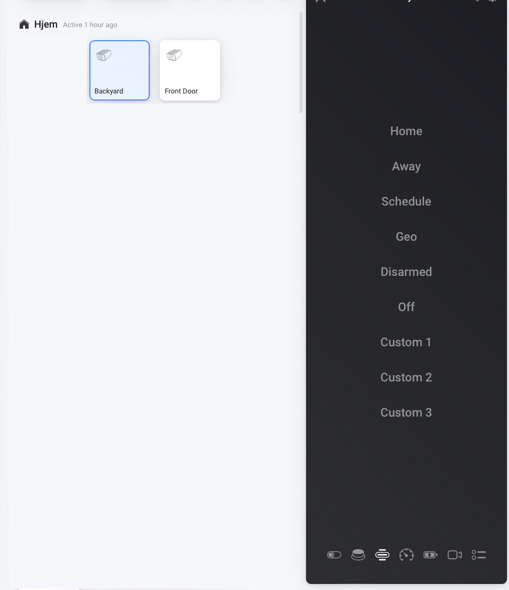

Hi! I’m trying to control my Solocams using your app in Homey Pro, but it seems really unstable and doesn’t really work. I have set it up according to your instructions but the flows keep failing. If you look at the images I’ve attached, it is a flow I started and then again a couple of minutes later. Both cameras are set to away in the iPhone app. Any idea what is wrong? Any help would be most appreciated!

I think it’s due to the fact the solocam is not reporting it’s status to Homey.
Best practice is to use Homey as the source of truth and let Homey control Eufy.
Due to the limitation in the API I can’t request the status without getting the user locked out :confused:
So for the current flow. Make sure to set the security mode first in Homey, so it’s aligned with Eufy.
You can do that from the device panel

@FranklyEpic sorry didn;t see your first message with question of the flow.
I think you need 1 flow. Because turning the night mode on and there’s motion is only a fraction of the event. Because that should happen exactly at the same time.
I would say:
WHEN motion
AND night mode is on
THEN do something

That isn’t working to well either I’m afraid. I try to set the status to the same that is in the iPhone app, but it times out and goes back to previous status or to no status at all. See attached images. Nr. 1: I try setting it to Home which is the status in the iPhone app, but it times out and goes back to Away (Nr. 2). Nr. 3. Here it times out as well and goes back to no status at all.
@FranklyEpic what you can do: go to the device settings, click reset data , click save changes, Eufy will try to update to the latest data.
A app restart might work too
