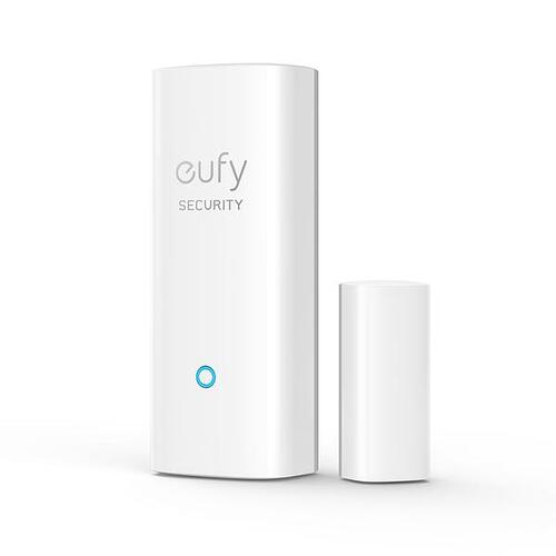

There are Eufy door and window opening sensors which are not Homey ready yet but with your app it could be supported similar to the cameras
Yeah, got the question multiple times now.
Should be possible, saw already somebody else who is implementing it.
So i’ll dive into that.
