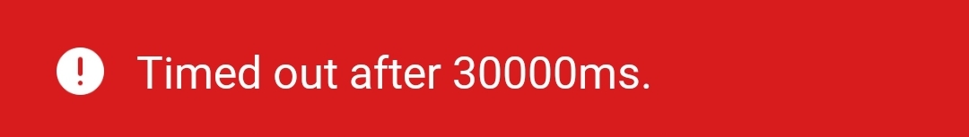

Now got a Solo S40 for outside, but again I cannot control anything. Not on/off not the floodlight.
Removed it, added and shared it again, filled in the local IP manually and synced the device data again.
The battery and temperature are reported.
If I set the mode to away manually, the thumbnail of alarm shows in homey. If I use homey to set away, it does set it but I get an invalid response popup. Setting home again also works.

Odd… Changing the mode is logged as event in the Eufy app, so that works. Thumbnail is available in Homey after an alarm event, so that cones through. Battery status is also shown.
Eufy events are shown in homey. Homey on/off is not shown in Eufy and it is not switching.
Both camera on/off and light on/off give a popup after 30s with time out. Is that a generic homey error or app specific?
@Floppus please keep this thread in English. Or move the question to the dutch subtopic
Events are not the same as sending commands so that makes sense.
The timeout is Homey related but also to this app.
