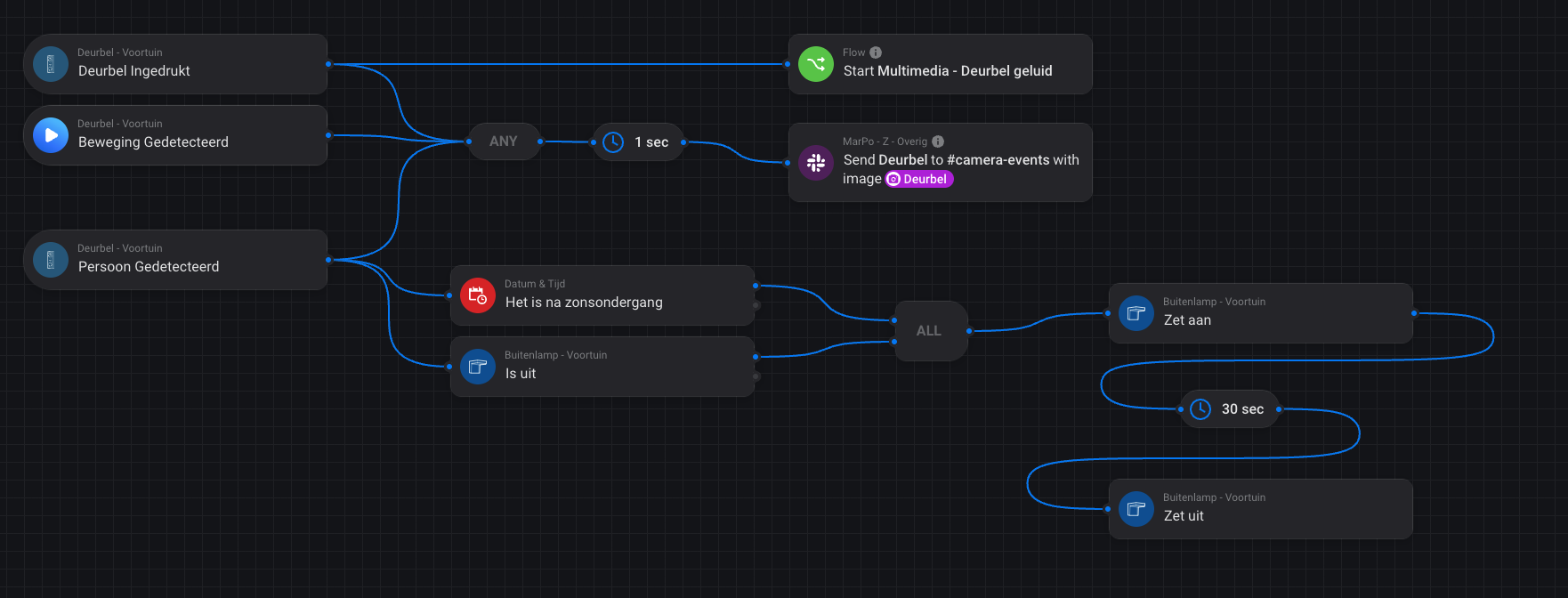

I think you are using the 'Beweging gedecteerd" card and not the “Persoon gedetecteerd”.
I have my flow set-up like this, so it will react on anything:

Tried the card “person detected”. Unfortunately, no message from my Homey when I left my home and looked straight into the camera.
Testing the flow showed the wanted result, so to my opinion the flow is correct.

It’s just a different card to show the difference.
There’s another card which you can use:
Generic Motion alarm. That will trigger if any of the events comes in.
