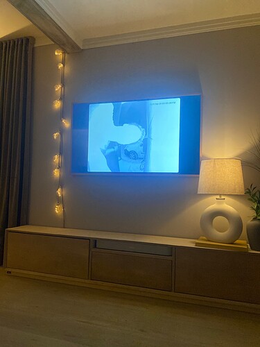

Does it have to stay on chromecast input? Or can i be watching tv, and the crhromecast snapshot overrides and pops up on the tv? I am having problems with it not popping up again… and the image from last time stays the same on the chromecast. It wont refresh when i press the button again…:sob:
Not sure about that.
You have to look in to the chromecast or tv settings to automativally switch inputs.
About the same image; yes that’s correct:
Doesnt it allso refresh through doorbell press?
Not always. Sometimes it does sometimes not
