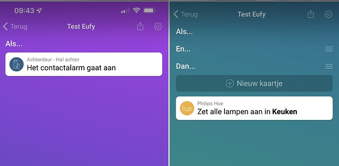

Hi Martijn,
I entered a new eufy account in homey …
but tiggers still not working, do I miss something ?
The test in homey is working, but in practice it is not :grimacing:
Just a simpel trigger ;
Hope you can help ? Thanks in advance.
Groet,
Raymond
Hey @Raymond_Sestig,
Are push notifications enabled in the Eufy app on your mobile phone?
Make sure they are enabled also in the selected Securitymode
@jonorland So i checked the logs and now I get your point :man_facepalming:
So when you trigger the Security mode from the Hey Eufy app the Trigger card Will not fire as the selected mode is the same as Homey just selected.
So indeed it’s a " feature " :stuck_out_tongue:
