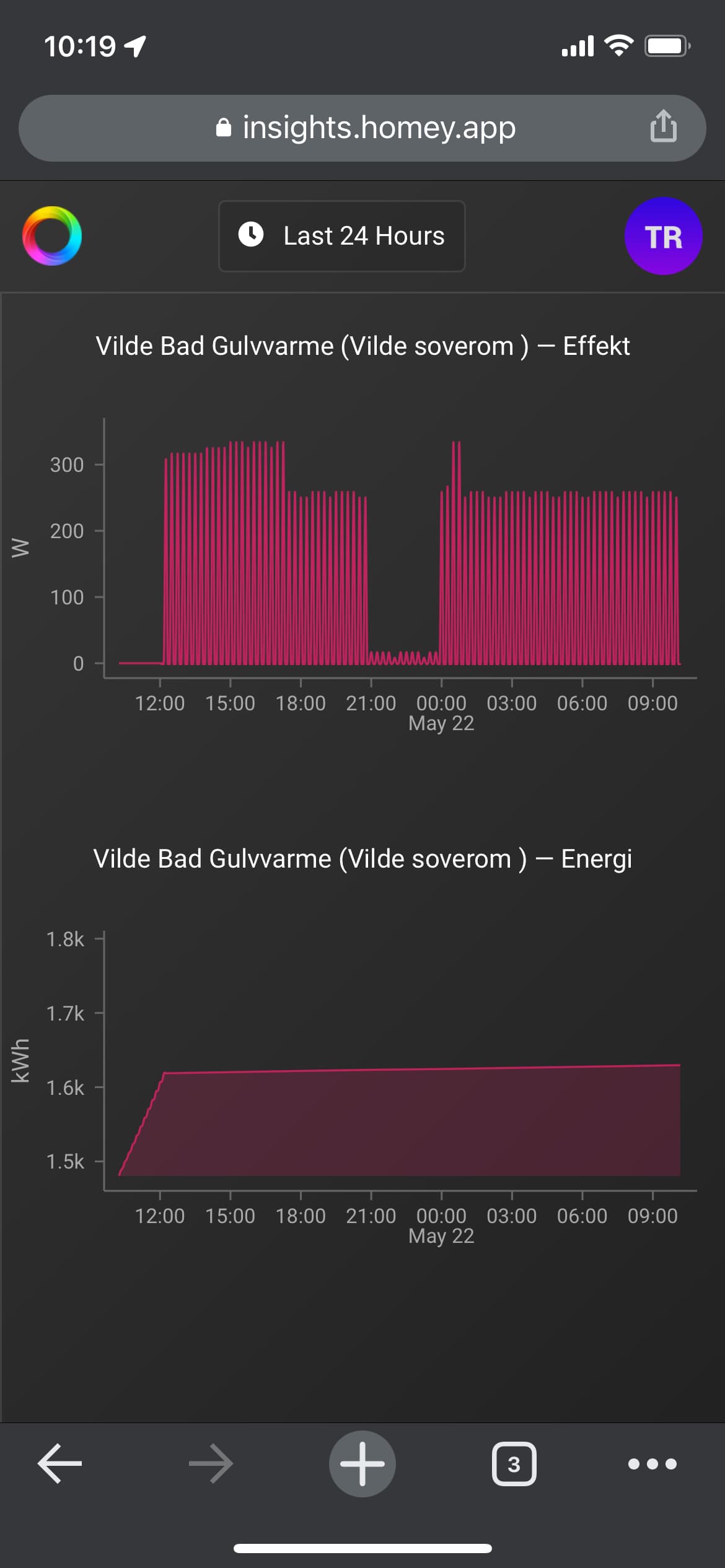

The problem with the insights energy graph “out of control” seems to be related to periods with zero usage. I changed the flow from 0% to 1% in expensive hours (which it was three hours yesterday evening), and the graph did behave. So it must be something wrong with the calculation when there is a 0 involved, I guess.
