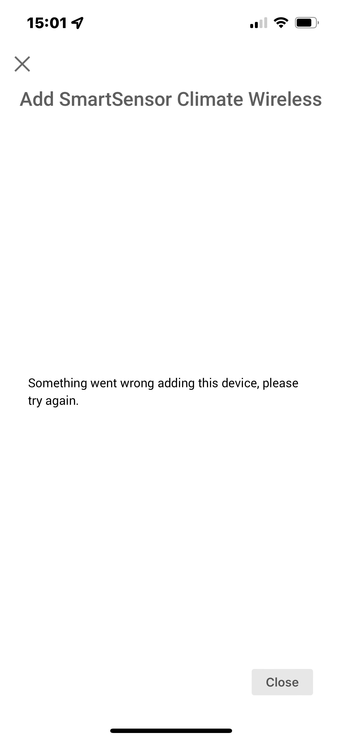

Having trouble connecting the smartSensor climate. Anyone else?

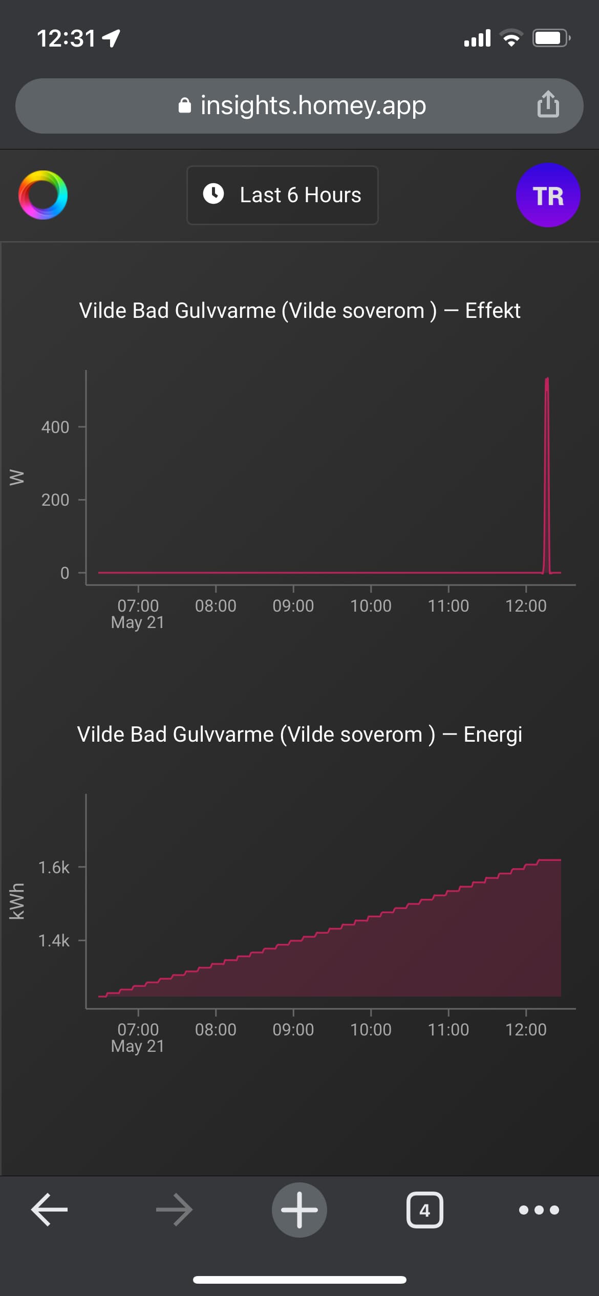

Update : stable connection to all three regulators (regulator mode). But one serious issue in energy calculation. Every time the regulator is set to 0% (during high price hours), the energy is increasing dramatically (and no actual heating, so it does not use energy).
