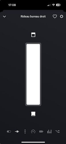

I hope you’re well. Since you updated the app, I no longer have disconnection warning issues with the Homey integration in my StreamDeck+. I have several roller shutters, and automatic curtains with position control.
