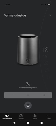

Does the fan speed also work correctly? Also, what is the lowest and the highest temperature you can set in the Duux mobile app?
Can confirm that the speed works correctly (1-3). It also reads the temperature (rounded to nearest degree). ON/OFF commands are almost instant, and it works well in Homey advanced flows.
In the Duux mobile app the lowest is 5C and highest is 30C.
The lowest is 5C? I had another user who had 18C as the lowest temperature? Perhaps you have a different model? Do you have the Threesixty instead of Threesixty 2?

It’s definitely the Threesixty 2 - I just double-checked the box. However, it’s possible the UK version is slightly different. When I ordered, I could choose between the EU and UK variants.
I will add a feature where it dynamically picks the minimum temperature based on the version, this way, creating 2 separate drivers isn’t needed, since they are the same except for the lowest temperature

I reported 18 degrees which if the lowest I have. I have three sixty 2 but EU version :blush:
I’ve now finished the update. You will need to add your device again (by removing and re-adding) to get the lower temperatures.
Note: you only need to do this with the UK version, for the EU version no action is required.
Let me know if it works
Have just tried re-adding it, but it still only lets me go down to 18C.
Otherwise, works well!
