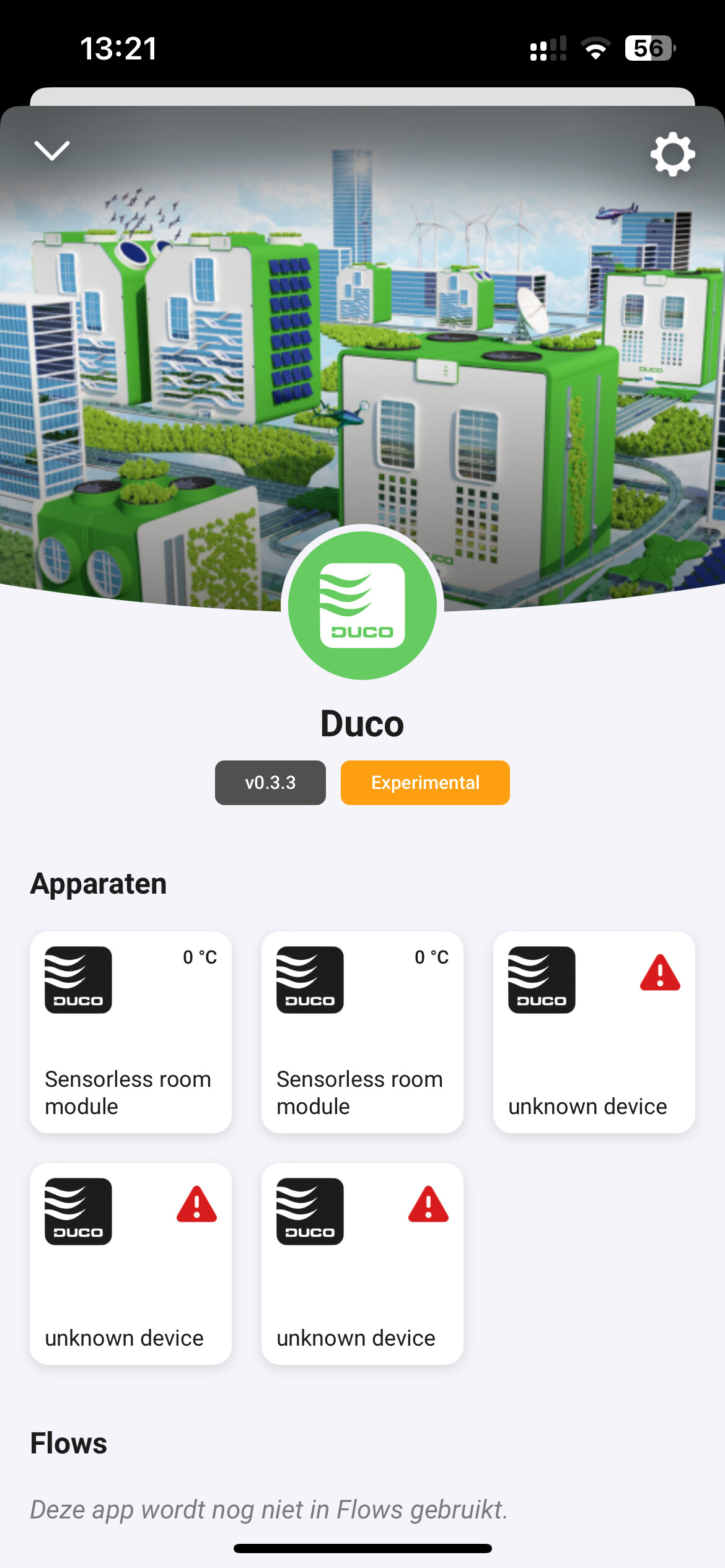

i tested your app, but it has some issues with a DucoBox Silent Connect:
  • i can’t install the app from github, because the app.json is missing
  • after some minutes the duco master gives the following error “Error: TCP Connection Timed Out”.
  • the RH Box Sensor and the RH Room Sensor are added as “unknown device” with the error “TypeError [ERR_INVALID_ARG_TYPE]: The “id” argument must be of type string. Received null”
  • I can’t find a way to adjust the ventilation mode.

I’ve tried it again after the new release, however it looks the same as before.
i know, they still have to be added. I have the discovery part enabled but for now I add them as unknown (default) device.
