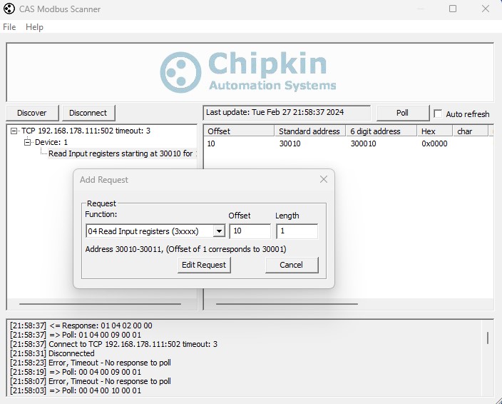

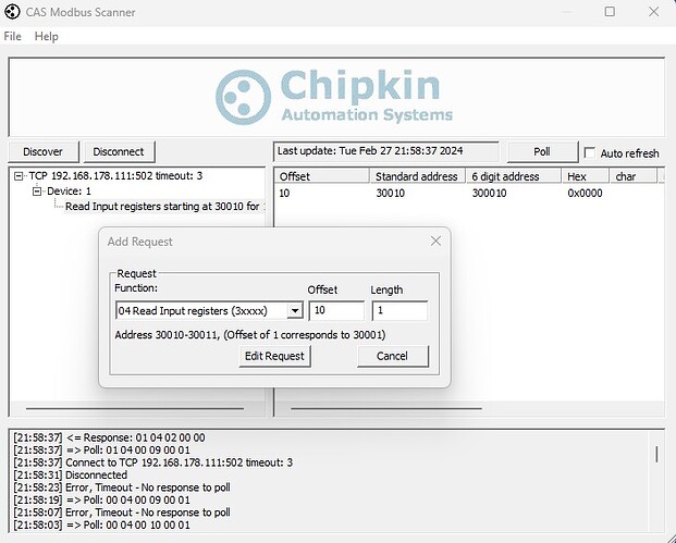

Hi @Cas_van_Bussel ,
It works like this, goto settings and configure a read. After that you can trigger the read by clicking the ‘poll’ button.
You should read a register 10 or 11 with value 10 or 17(decimal)
Oh, looking at your results, can you read 0 (zero?)
Tjar
February 27, 2024, 9:19pm
43

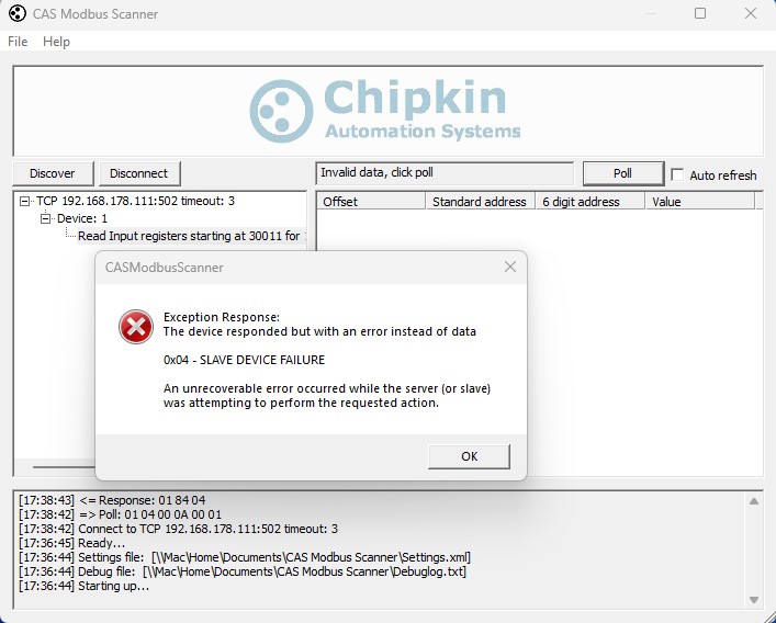

yes and register 0 (zero) and register 11 please.
Hello Tjar,
Do you mean with register the value in " Offset"?
When I put 0 in Offset I’ll get the message: value in Offset must be greater then 0
If I put 11 in Offset then I’ll get the following error:
Tjar
February 28, 2024, 4:57pm
45
So the first device page on your Modus interface is from 1-10 in your case. 11-20 is a new page (the device is not present.
That differs from the current implementation on which the first page starts at 10 (up to 19).
If you read register 1, with length 3, what data do you receive?

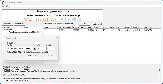

Hello Tjar,
I’ve tried the following setting and then get as result 17 on register 10:
This is the information I get from register 1 length 3
Tjar
February 28, 2024, 5:19pm
48
Have you got a link to the datasheet?
I didn’t expected zeros.
Tjar
February 28, 2024, 6:28pm
50
thanks! Can you read register 100 with function code 4?
it should return 17.
Tjar
February 28, 2024, 6:59pm
52
oke, so your registers are different. Well, now we pinpointed that we can work to a solution!

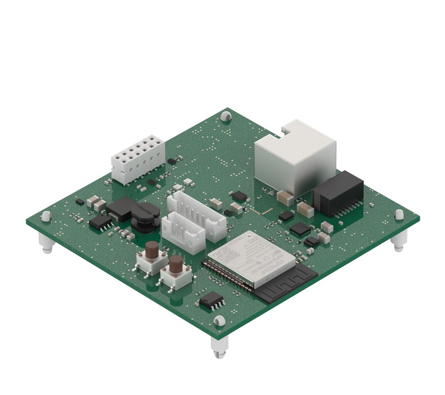

Hi everyone, did anyone got the new connectivity board working with the app?
I have tried to search for devices but get the following error:
*duco connectivity board (2023)
*duco WTW energy premiun 460
Tjar
May 1, 2024, 8:10pm
55
Hi Jeroen,
there’s an action required from my side. The Duco adresses and device IDs are different, therefore the scan doesn’t generate results.
Hi, Thanks for the response! If you need any help or testing let me know!

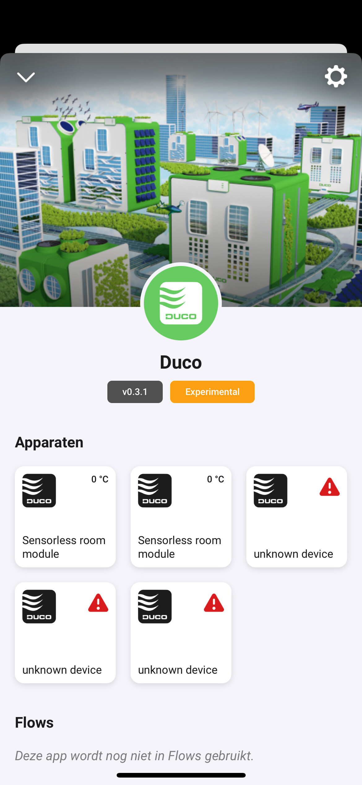

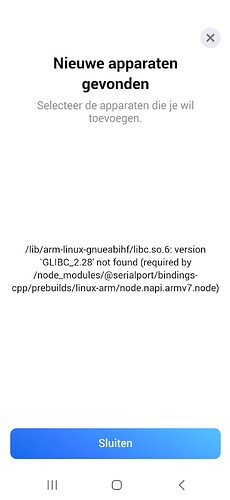

Hello Tjar,
I’ve noticed that the app has been updated so I tried to add the ducobox focus, however I can’t add any devices in homey using the Duco app. It shows the red triangle warning signal.
Regards,
Tjar
May 22, 2024, 7:35am
58
Hi Cas,
Yes sorry for that.
I noticed the failures in my system to
It’s fixed in 0.3.1
Please try to discover the master.
Note that the device is “incomplete”, I want to focus on the discovery first.
