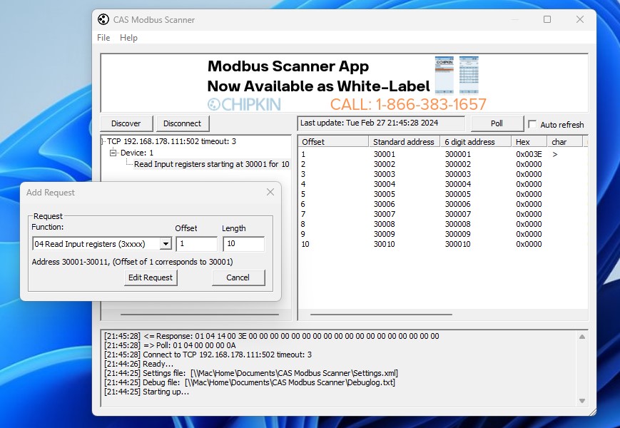

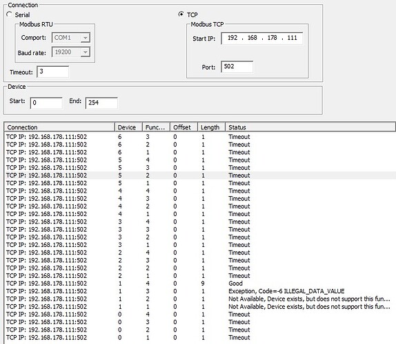

Hello Tjar,
I’ve just used CAS modus scanner, see picture.
I only have the box at the moment, I need to install 4 valves (I allready have them).
Regards,
Hi thanx, that’s helpfull.
Is there a regsiter you scan for? I notice you start at address 0 with a length of 9 on ID 1.
Can you read address 10? length 1, with function 4 on ID1?
Best regards,
This is the first time I’m using CAS modus scanner, So I’m not so familiar with this program.
How can I read address 10
EDIT: Do mean the following:
