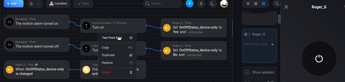

I tried searching this topic for a solution, couldn’t find one. Hope to get help from the experts here.
I created a new device, very simple and straightforward. It’s meant to function as a normal button to switch on my Christmas lights. To do this, it starts a flow that triggers several wall outlets and so on.
But…in the morning and in the evening the lights are switched on and off on fixed times by this flow. The status of the button isn’t adapted, so the next thing can happen. I switch on the lights with the new button. The status of the button is “on” and the lights are on.
When the lights are switched of by the flow, the lights are off and the button is still on. Vice versa.
Is there a way to activate or deactivate the button. But without activating the flows, because that’s what I get now when I activate the status, turn the button on (or off).
What capability do I have to give to the button? And how can I get this (de)activated?
Hi Peter, this is exactly as I have it. Pressing the button on and off functions perfectly.
The problem arises when I want to turn the button active or inactive, but without running the flow that starts after switching the button on or off.
I have to do so, because the lights are (also) switched on/off on a fixed moment, independent of the button. I want to keep the button in sync with the lights, so to say.
I can’t find the status of the button I can change without the button being pressed, so without starting the connected flow.
you should use different triggers and action cards then you are doing now (probably).
Trigger (WHEN): “When button ...” and select “has changed”.
Action (THEN): “Set [Button] to [yes/no] and [Nothing else]”. that won’t start the used Trigger
Maybe I don’t understand your solution completely. When pressing the button to on or off, the status changes automatically. It’s not necessary to change it manually, as you in your “Then” statement?
To my opinion, your solution doesn’t solve my problem either. If I only wanted to use the button to put the lights on and off, then it works very easy. Its status changes to on and off after each time I press it. And the flows are executed.
But I only want to change its status manually. When I do so using your solution after Then, the lights still go on ( status to yes) and off (status to no).
Do I overlook something?
Please show a printscreen of your flow with the trigger that reacts to the button being pushed?
Becuase that one it probably the default homey card, and you need the special AVD when card.
Ah I got you wrong then ![]()
So you want a status ‘copy’?
Like, when a device is turned on/off, your switch has to turn on/off as well?
I guess @Caseda was right, Roger. But it can be quite complex sometimes.
Take a look at this example. The flow(s) with ‘this switch has turned on’ will not trigger when you turn the switch on and off with “and nothing else” option.
→ only if you manually operate the switch, the flow(s) with ‘this switch has turned on’ will trigger.
If this is not what you’re looking for, I just got you wrong again I guess ![]()

As I wrote already, I created a really simple ADC. Just a sensor to show the status of a kind of door sensor (link, sorry only in German language). But I changed the settings of the sensor every now and then and tried things out. And I did a restart of the app, if I remember correctly.
Hi @Roger_Gorissen,
as Arie already wrote, please post a screenshot of your flow.
I guess the problem is that you just programmed one way. And that is only from the point of view of the switch, and not from the point of view of the lamp(s).
The way back is probably missing. If at a certain time the x lamps are switched off, then the button must also be switched off.
Switch button on → switch lamp on
Switch button off → switch lamp off
Lamp is switched on (e.g. by time) → button has also be switched on
Lamp is switched off (e.g. by time) → button has also be switched off
However, a generell problem is that you switch several lamps. What happens if only one lamp is switched off/on (e.g. by a time setting or manually), but other lamps remain off/on?
This is a sample where you can control up to 5 dimmable lights, made by @Arie_J_Godschalk. I guess something similar has to be created for your case.

You describe it exactly as I mean. Switching lights on using the button is no problem. Lights react as supposed.
Problem arises when lights are switched off by another cause.
The status off command that @Peter_Kawa shows in his flows is exactly how I used it in the flow that switch off the lights on f.e. a fixed time. But strangely, the flow that is connected to the button is also activated, despite the “and nothing else”.
Even when I make a test flow: WHEN this flow is activated THEN status on and nothing else, then the lights are switched on, caused by the flow connected to the button. Seems like something is not working properly.
I don’t understand why I have to share the flow of the trigger when the button is being pushed? That part works okay.
I make a new button and see if that one works as it should be. I’ll take your suggestions and advice into account.
Keep you informed.
Because it looks like you use the triggercard from Homey itself: When xxx turned on.
That one will always trigger!
Even with the custom flowcard with “nothing else”.
As trigger, you need the custom AVD triggercard “when xxx is set/changed/pushed”.
That one will not be triggered by the NothingElse card.
