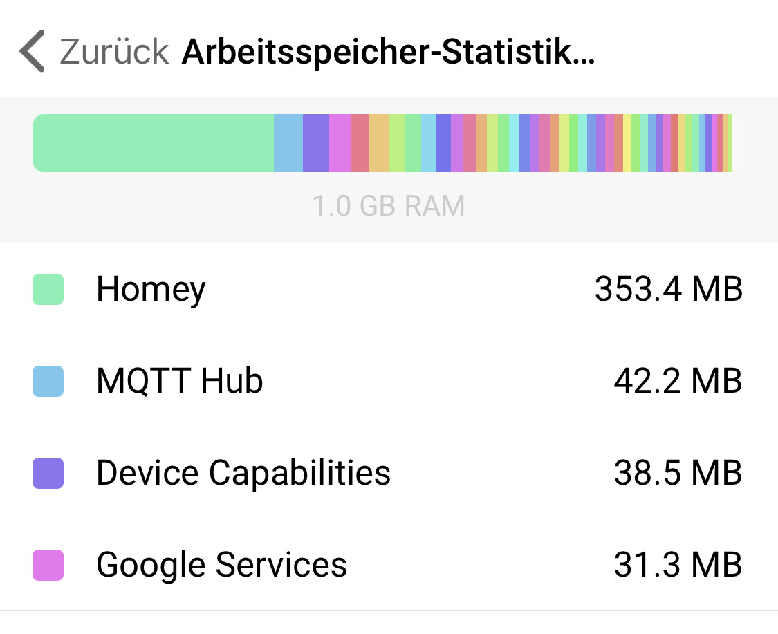

The memory usage is reaching its limits and Homey is getting sluggish at times:
I am already looking for ways so that I can do without 2-3 apps and delete them. But this was not necessary until recently.
What I also can’t explain why Homey uses so much memory (353 MB!).
Sorry Peter, but I see it differently. As far as I know, Athom specifies that the memory consumption of an app should not exceed 30 MB.
I think that the MQTT Hub app should also not use more memory than 30 MB. If the app could be optimized regarding memory consumption I don’t know, I’m not a programmer.

i have the same since a few months: after a Homey restart, i use about 50-60% memory, but that will keep growing.
I already disabled DC for a few days, but still, Homey keeps growing aswell as all apps that use the athom-api (like HS).
Also apps without the Athom-API will grow, f.i. the Google Service App: Yours shows 31MB right now, but mine 25MB (and it should be about the same).
If you restart your Homey, i am (pretty) sure that the GS will use way less MB, around the 25ish.
This Memory buildup is since the 8.0.0 or 8.0.3 i think. I didn’t have this isue at least before, but it might be an app or something ofc also.

Well, please note, this is a very straign point of view imho.
For example, when you include and use the Athom-API, you are already gonne be at about 20MB.
But also, for the Google Services i needed to include the Google Cloud API’s: this alone makes the app run at 23MB minimum.
Perhaps when the “bugs” or growing issue is solved, it will be different.
So i guess i would agree that an App, after full Homey restart, should not use more then 30MB in most cases :wink:

Ah, you got me wrong :grimacing::hugs:. I will explain myself better:
I was trying to say I was thinking for myself that this app is, for me, allowed to use over 40 to 50MB’s, while it is so handy and useful.
That’s why I did not report it as an issue yet.
I do agree the memory usage is a bit too high, but I can’t imagine it is possible this app would use less (no clue how that works).
I mean, like I mentioned, an app like MQTT Hub uses over 40MB’s all the time. Appearantly this can’t be reduced for that app.
Device Capabilities is like 5 apps into 1 :upside_down_face:
I also agree apps in general preferrably should take as little as possible memory, so we can run more neat apps with the mere 1GB of RAM.
(I was stunned the Pro 2023 got only 2GB and not 8GB…)
