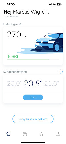

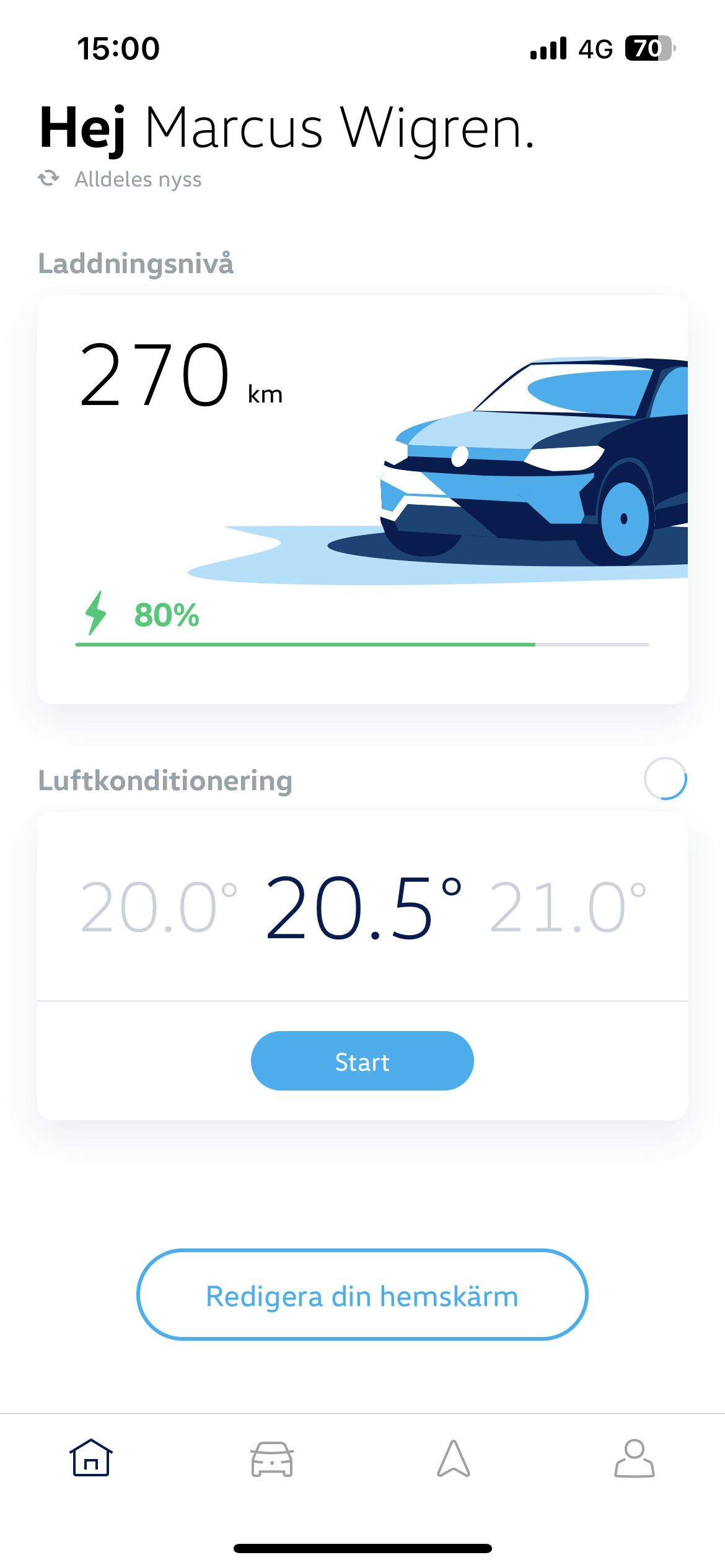

The official app works and says 270 km right now.
@koolla and the total range?
What do you mean by total range? This is the only range I have in the “slim” VW-app

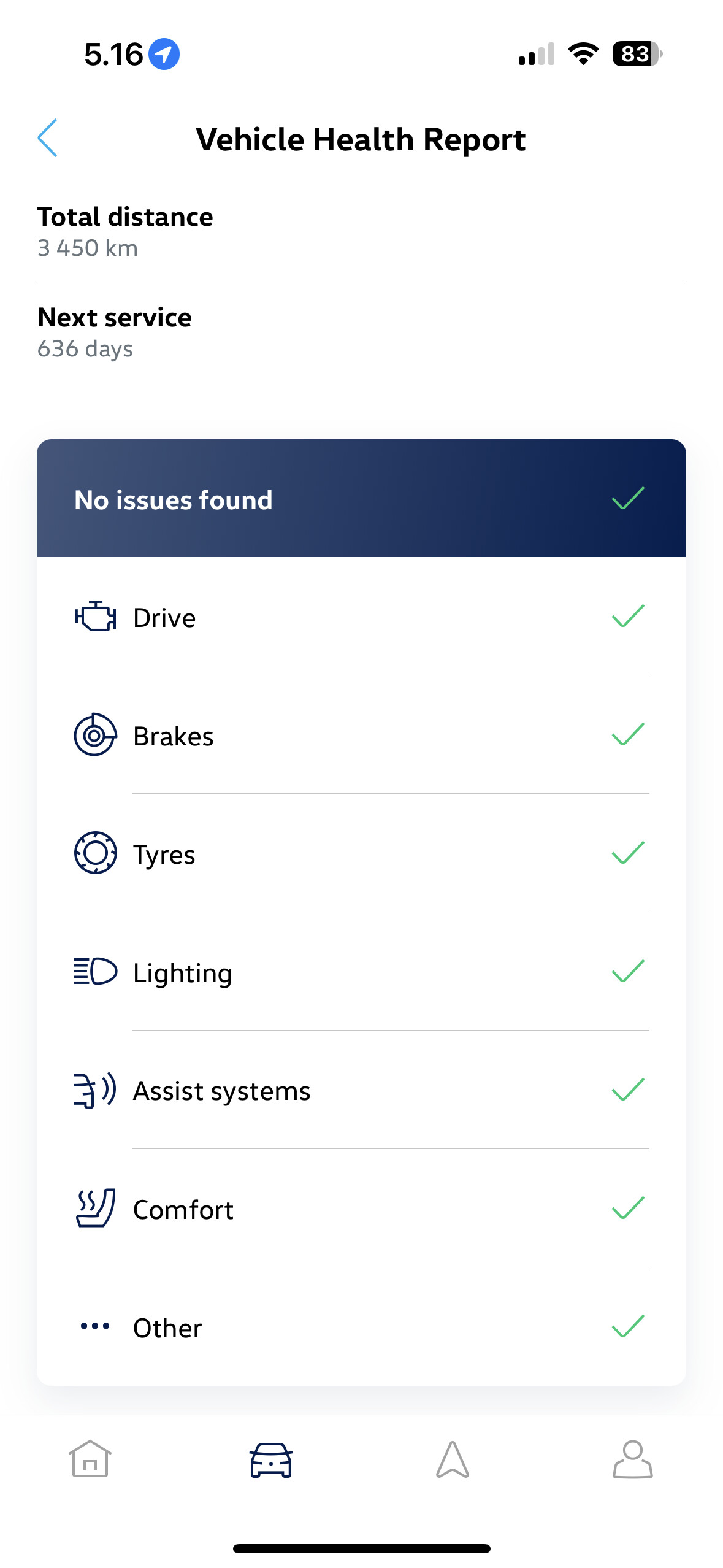

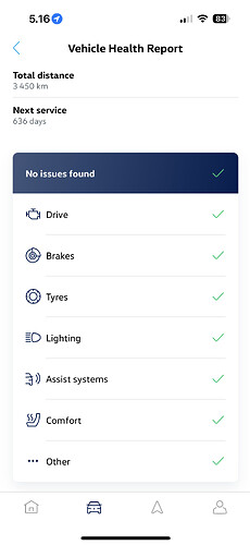

Sorry I meant odoMeter. So the driven mileage
There is total distance used for the odoMeter in Vehicle Health screen in the We Connect ID app.
I cannot find this vehicle health screen. Running 3.0 after OTA update.
In the mobile app, it would be in the vehicle (second) view and from there you can:
  • select to charge
  • control air condition
  • departure time
  • Vehicle health
Select Vehicle health and you end up to the report.

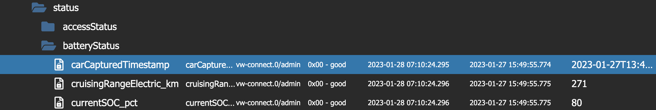

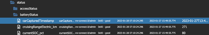

@koolla I found a different value in your logs which might be usable for the range.
Still seems like your car is behaving different than other ID cars and giving those errors as I shared earlier
