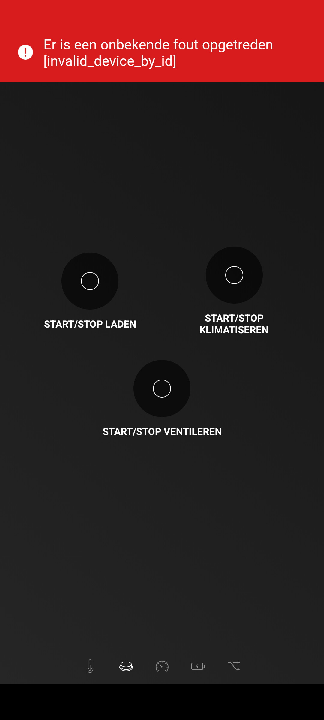

At the moment I have this issue when I press the start charge button: „invalid Device by id“
59ff83fd-18e4-419d-843b-34c00183bee5
Hoi Martijn…
I connect the loading cable with my enyaq I didn’t got any response. Also I start climat etc I got this message
@SvenRhein @Ben i will check that
