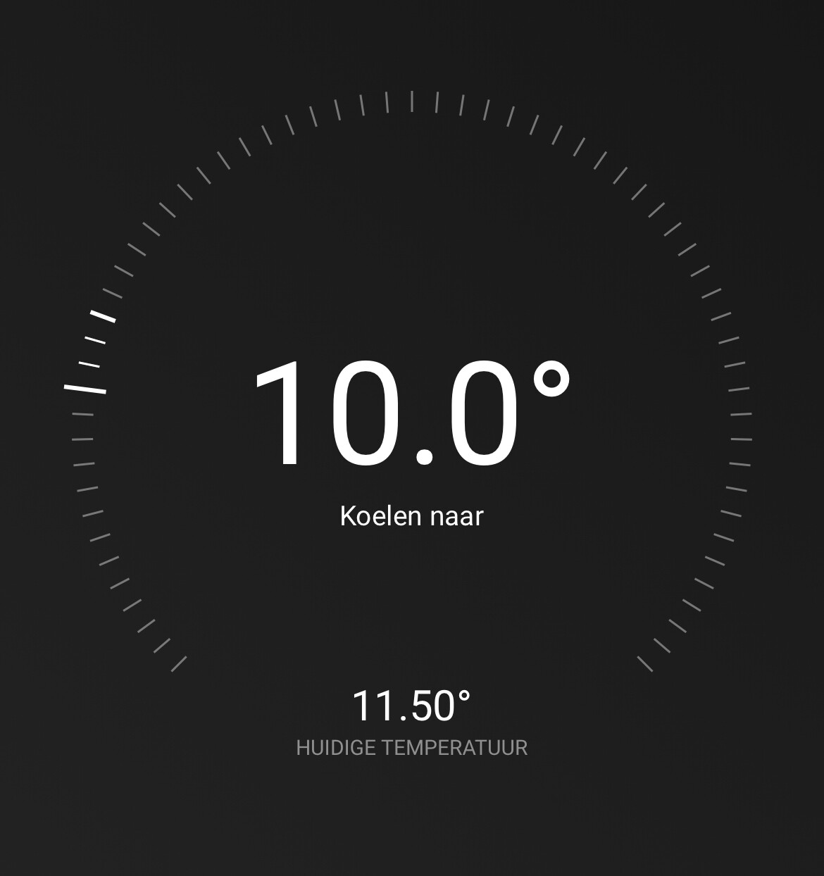

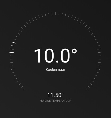

If your car doesn’t support the temp it’s indeed not possible. i cannot really see this in the API so it’s quite hard to find the difference per car/model/accesoires.
you can disbable the temperature remote via the device settings. :slight_smile:

@Harry yep you’re right. I will make a option for that. Didn’t expect that a car would have climater option but not the temperature option. :sweat_smile:
@Harry I did quickly check the data I got from you. But it looks like your car supports it somehow. At least it reports data for the climate temp :thinking:

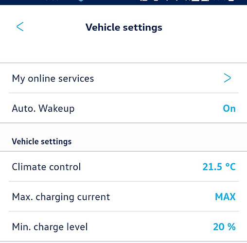

When you go to the settings in the MyAudi app do you see anything over there?
That’s where VW hides it:

Stefan also has an Audi Etron 55 with these target temperature in the Audi app, but I don’t have this option in the app. Strange, maybe a different type of clime control?

There’s nothing remotley like this in the (in my) MyAudi app. MyAudi app is really featureless (in dutch “kut” :wink: ; a button to set one climate schedule, a button to set 2 charging schedules and a button the see some drivinglogs. No “car settings” at all.

Regarding Homey and temp:
The temperature in my car is set to 20,5C, but the app always shows 22C, changing it does nothing.
