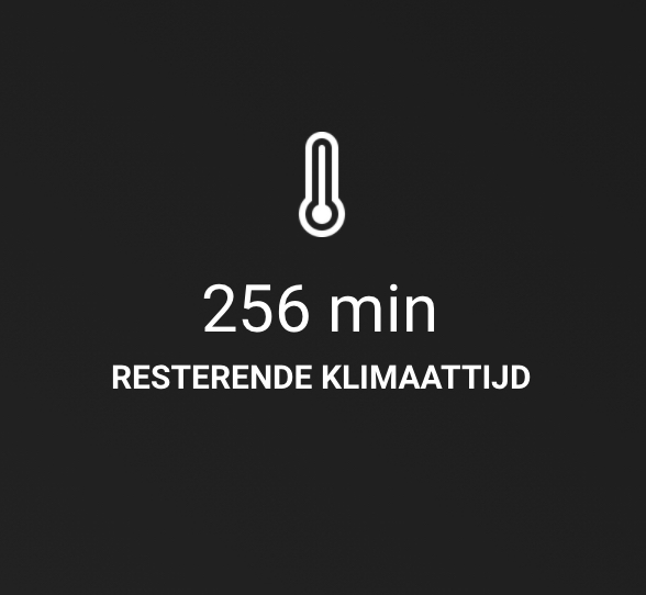

The remaining clima time does work when the clima is started, but it shows 256 minutes when the clima is not started.

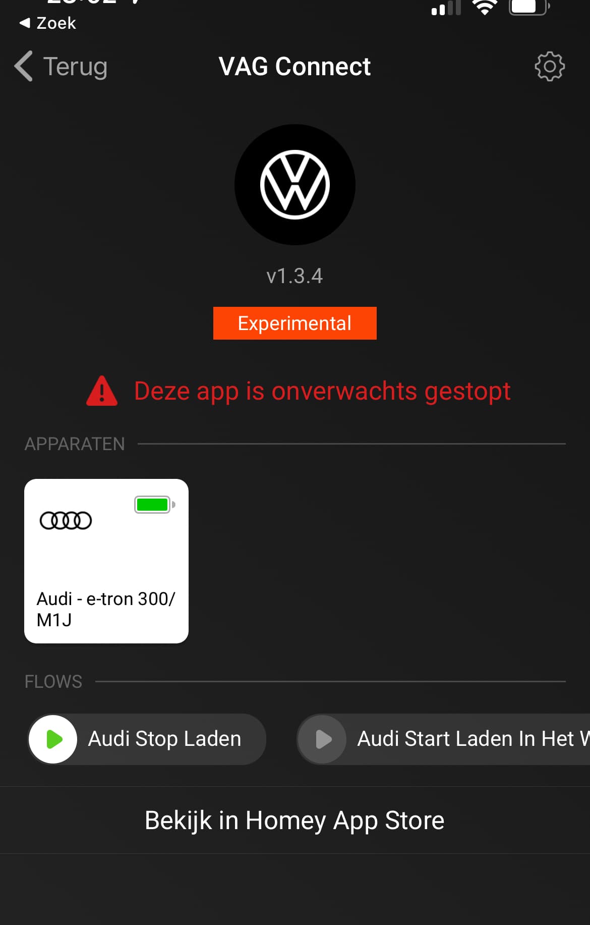

Hi Martijn,
App looks active but on the page where you can create the report it indicates that the app is stopped.
Report: 74bac24f-f3e5-4fbe-a514-180c45f291eb
Of course! 4dcfde56-5ac7-4467-a107-5658ce9ae5f5
@Harry can you click the red triangle in that screen, it should show a reason

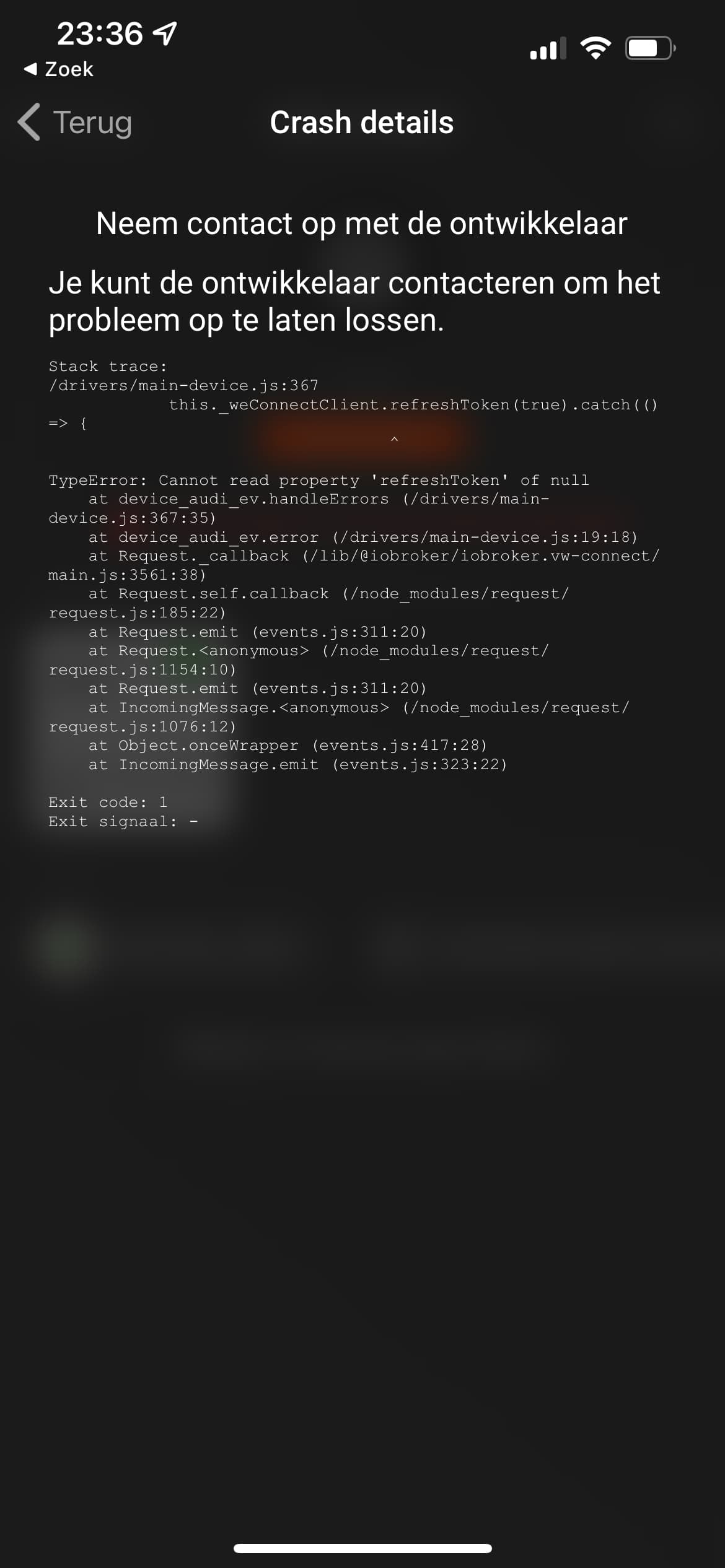

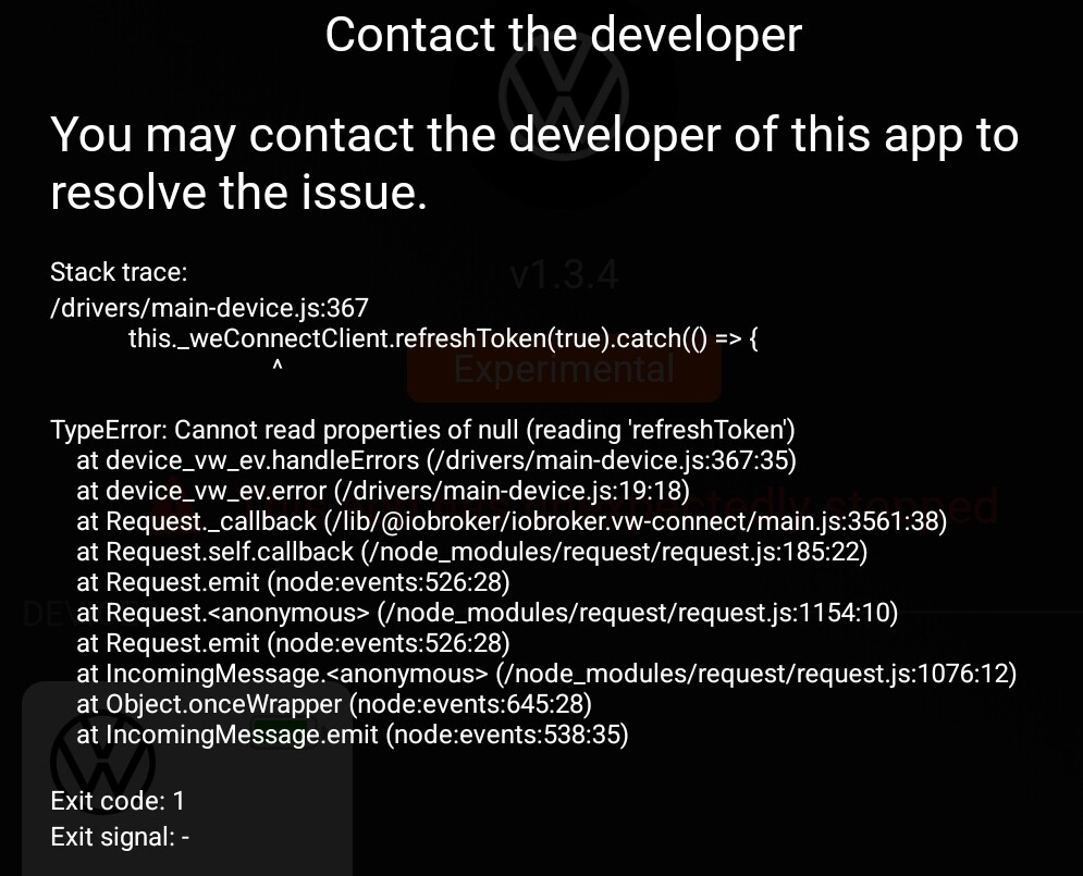

@martijnpoppen
App crashing
024f34f3-cd99-4db6-8b90-f0d02dd1ca9b
0993f8a0-14b3-40b7-bfb1-9d2647935ae1

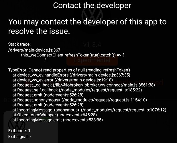

Mine stack trace is slightly different :
Also unfortunately not updating any of the values anymore.
Will fix guys

  • FIX: app crash
