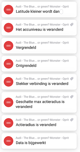

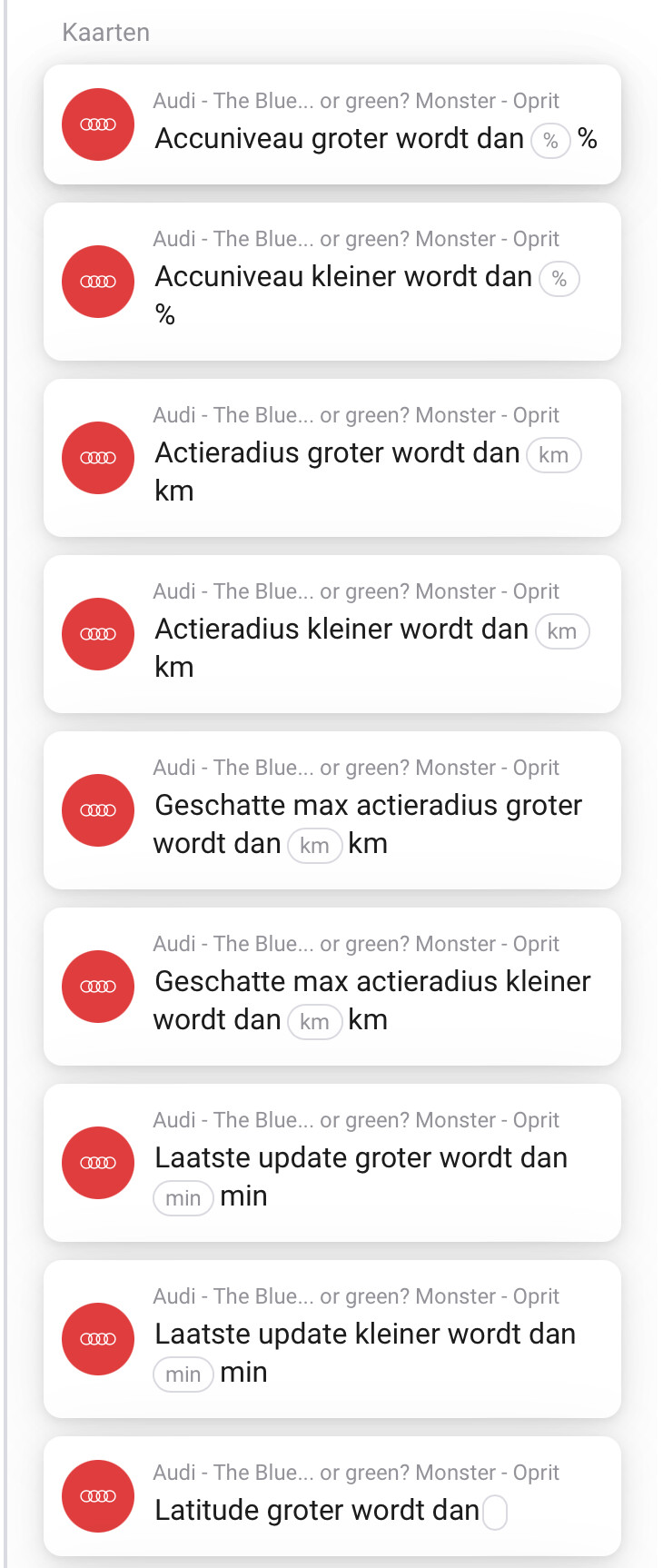

Hi, I am trying to figure out a way to use the MyAudi app and my own location to trigger a push notification when the car is not locked to my phone. As Audi does not have this notification (beats me why, merc has it), I thought there might be a smart way using the myAudi app on Homey Pro.
Any ideas how to do this?
@Alexander_Bohm you can do something like this:
Unfortunatly I do not have moving/not moving or any other location related Myaudi cards. Only cards related to the battery level, lock/unlocked and range indication. See screenshot. Any ideas based on that information?
@Alexander_Bohm it would help if you can tell which car you have :stuck_out_tongue:
Good one. E-tron 50, 2019. So much information needed to get this right.
Ah yeah Audi Etron doesn’t report moving :frowning:
what you can do maybe is when the actieradius has changed and base on that you can check the location with your location.
