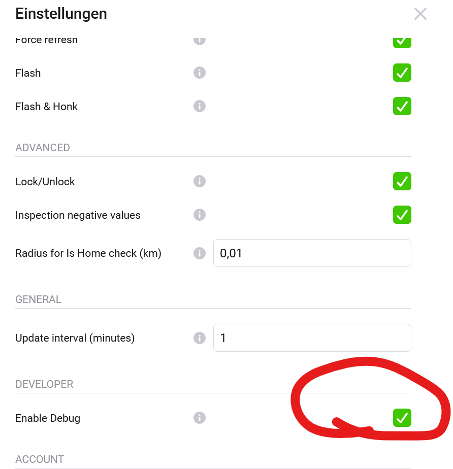

@homey_mike can you enable debug in the device settings and try a climatisation option and after that send a new report? :slight_smile:
Hi @martijnpoppen , thanks for you helped. I’ve just sent you a new log with enabled debug. ID: f9e4099c-7902-404e-bc85-b7ba05f1703d
