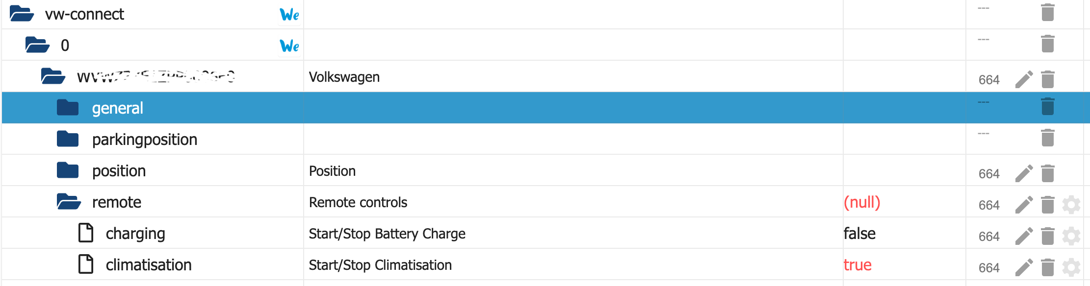

I’ve tried all the three different “climatisation” version settings from the device settings on my ID.3, but can’t seem to control it on or off and doesn’t seem to reflect the actual status.
From iobroker I can switch it to true and false and works from there:
under status even ibroker doesn’t see climatisationStatus
@OH2TH i see, probably the ID remote function take value “start” instead of true :person_shrugging:
@OH2TH nevermind, that will be handled in the iobroker lib. So according to my setup it should work.

I think there is an issue in iobroker that the state is not seen from Volkswagen We Connect service.
