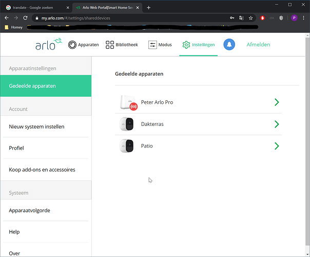

@Peter_Peerlkamp -
  1. Can you please login to the Arlo app using the account which you are logging into my app with, and then take a screen shot of where you have shared the cameras and enabled the feature I linked you to.
  2. Then please restart my app and send me a diagnostic report 30 seconds later.
  3. Finally please read the information about using a separate account for Homey then what you use as your manager account in Arlo.
Thanks
Dear Jamie, thank’s for your answer.
Hereby I send you the screenshot of the available shared cameras for the account i’m using for your Arlo App. This is my diagnostic report ID : 060a79a0-a5eb-4f64-81a5-aacf598340b3.
Unfortunately, when I log into your app with my arlo admin account, I cannot add my cameras as well.
Maybe i have to try to re-add one camera again.
I’m sorry for the problems, but your app is great and I really to get it working.
Maybe a stupid question but is it Arlo Pro 2 you are trying to add and not just pro?
Totally correct my mistake. In my earlier text I am talking about arlo pro 2, but I have an arlo pro VMB4000. This device is also supported.
For now only pro 2 cameras are supported. VMB4000 and VMB4500 base stations are also supported. Not pro cameras.
