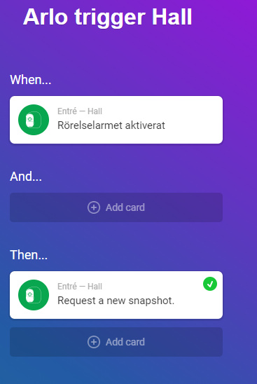

So I couldnt for the life of me find any way to ask for a Snapshot, only the Notify when a new snapshot is available. Noticed a bit up in this forum that there are test versions out, so I think I managed to grab the latest available (ver 2.4.301 ) and now I got the ability to do a Request.
So setup a basic two step flow, first flow when motion is detected - > request new snapshot from that camera. And the second flow, once a snapshot is available, send snapshot picture over, for example telegram. This still doesnt work for me. When I “test” I get green check marks on the first flow but then nothing. If I test the second flow, I get green check mark and a picture is received on telegram as requested. But it’s not working on its own, I see that I have movement, but nothing triggers.
Can you confirm I have the latest working version ( 2.4.301)?
Or am I still misunderstanding the logic here?
The only thing I can think of is that your already recording … you can’t ask a camera to take a photo if it’s already recording a video …
I’ll try and see if I can get similar flows working
