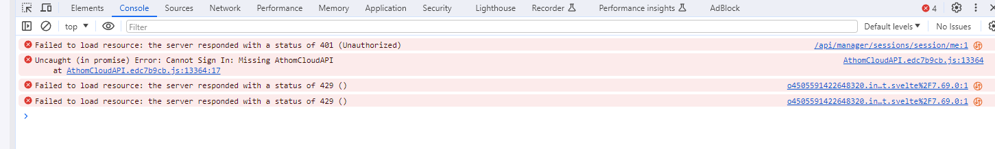

This is when I load the board url
This is with the empty device list on screen
Does this tell you anything?
EDIT: I’m seeing that 429 server response also when I try the the other URL. Google tells me this means " The HTTP 429 Too Many Requests response status code indicates the user has sent too many requests in a given amount of time (“rate limiting”)".
But I otherwise I have very little idea what i am looking at here :expressionless:
The 429 Calls to sentry.com are not important, that is only a error snapshot service for the developer.
But 401 „can not log in“ means eather the API key is wrong or does not have enough permissions…

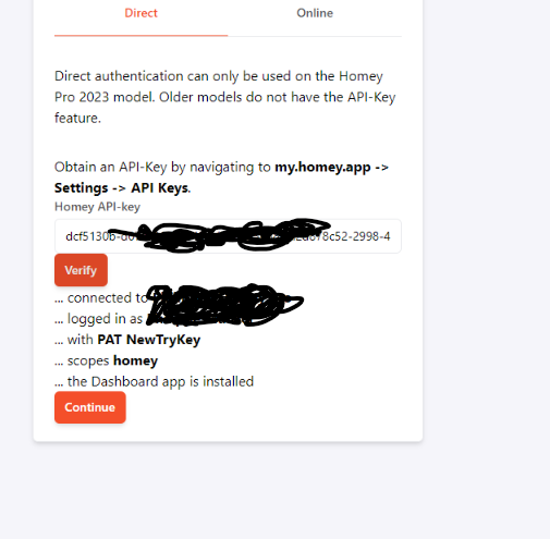

Aaah, thank you @Torsten_Sturm good to know.
I tried with a fresh API key.
  • Installed two dashboards via the app. “Dashboard”
  • and “SecondDashboard”
  • Cleared my cookies.
  • Went to the app settings (on PC homey developer tools) hit the local butting. Bunch of remarks on that page that my API key is accepted.
  • No Boards to be seen :frowning:
  • Now, in a fit of desperation, I went to the other buttons on the app settings, the Remote button and the GitHub button and connected with the new API key to both of those.
  • Now I don’t know if that was it, or just some time needed to pass. But after that, when I hit the local button:
  • BOOM! I can see the two dashboards, and edit them. Yesss! :slight_smile:
