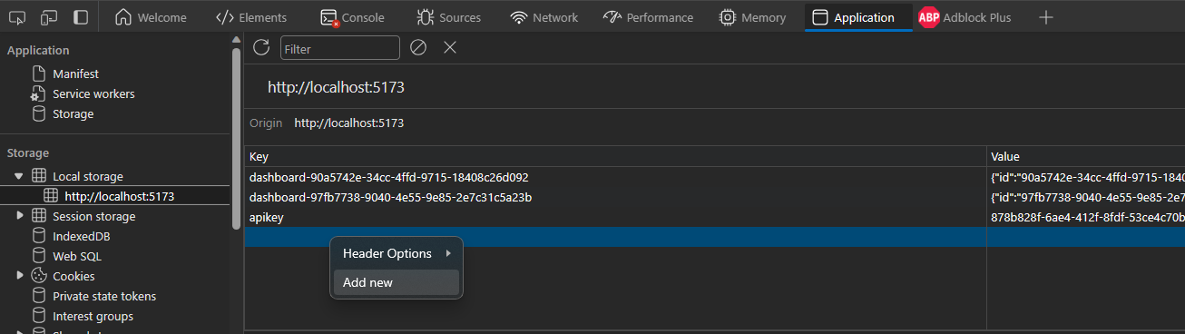

A workaround is to add the apikey manually. Open the developer tools (F12 on your keyboard), go to Application → Local storage → right click and select Add new → key should be apikey, and value should the api-key you generated in HP23. Press enter to save the row, and just refresh the page.

This helps me reach a dashboard, and ow, it is the same one as I was editing in homeyboard.github.io. Now I get it - THAT is the one that is stored on Homey. OK, despite workaround, some progress.
What I do not understand is this. Adding the api key in that F12 devveloper tools thing - where does that actually store the key? Some kind of cookie? It only helps me to reach the board with this browser, correct? I suppose it will not help me cast a local URL of the board to my Nest, correct? That is the goal. Casting this local boards URL doesn’t work. (I can’t make the online homeyboard.github.io version work either, but - one thing at a time).
