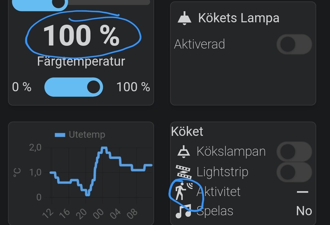

Is there any way to remove the 100% in large letters and only have the slider?
The icon (I found it first but now now. What is the the name in the search field
Im not 100 here but i dont think you can sins there is no additional options for the capability widget.
