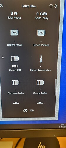

Yes, confirmation. Temp now show inverter temperature 24.3
Some cleanup at the bottom of the values page might be in order.
Bat pow/vol/soc/temp likely leftover from std solax
Also - for some strange reason discharge/charge today doesn’t resolve :thinking:
Med venlig hilsen
Jørgen
tir. 2. dec. 2025 12.06 skrev Michal Stráník via Homey Community Forum <notifications@athom.discoursemail.com>:
Perhaps the charge today should be
Function code 0x04, register 0x0091
and discharge today should be 0x0050
( as shown on page 21 button)?
Med venlig hilsen
Jørgen
ons. 3. dec. 2025 07.06 skrev Joergen Seemann <jorgen@seecom.dk>:
Ah. No. That’s the energy im/export which you show below. My bad. Sorry :grin:
I cannot see any registers for battery charge/discharge total today (its not in history data section), so I guess this isn’t supported on the Ultra :thinking:
Med venlig hilsen
Jørgen
ons. 3. dec. 2025 07.12 skrev Joergen Seemann <jorgen@seecom.dk>:
