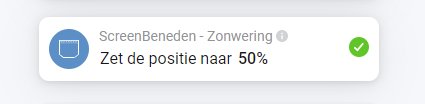

@Phuturist I’m trying to set a sunscreen to a specific position. It works when I just use a percentage setting in the card like
but fails when I use a calculated value (the calculated value is 0.375)
Should this work? Or am I doing something wrong
edit: hmm duh, 0.5 is not the same as ‘50%’ of course, I was assuming the % setting is still a numeric thing. Should I feed it a textvariable x%?
I was expecting this to work since al other options to check state do work with values between 0 and 1
This is a built in action card based on the the windowcoverings_set capability. According to the docs it’s a 2 decimal value. Try 0.38.
I tried that, but it says “token out of range” (same as when I make it 38 just to test it)
edit: it worked when I tried again. Maybe the variable wasn’t updated properly (although it said 0.38 in the list). I added a Round() to make sure it only 2 decimals
Seems to work now, tnx!
