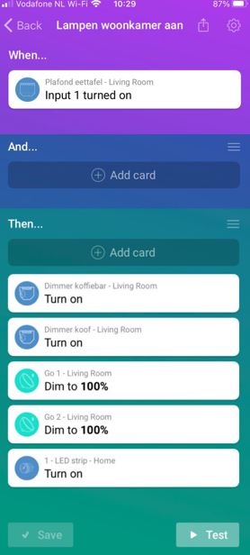

I found that running the app with COAP enabled, certain flows are working only from time to time. If they work, they respond as they should and the processing through Homey is very fast since the update! However, every now and then I flick the switch and Homey doens’t execute anything. This irresponsiveness can last for several minutes at least (then I stopped trying flicking switches) The Shelly reports it’s status change just fine in the Shelly app.
With COAP disabled everything works well all the time.
Has anyone faced a similar issue perhaps and can point me in the right direction to solve it :slight_smile: ? See below my (simple) flow.
