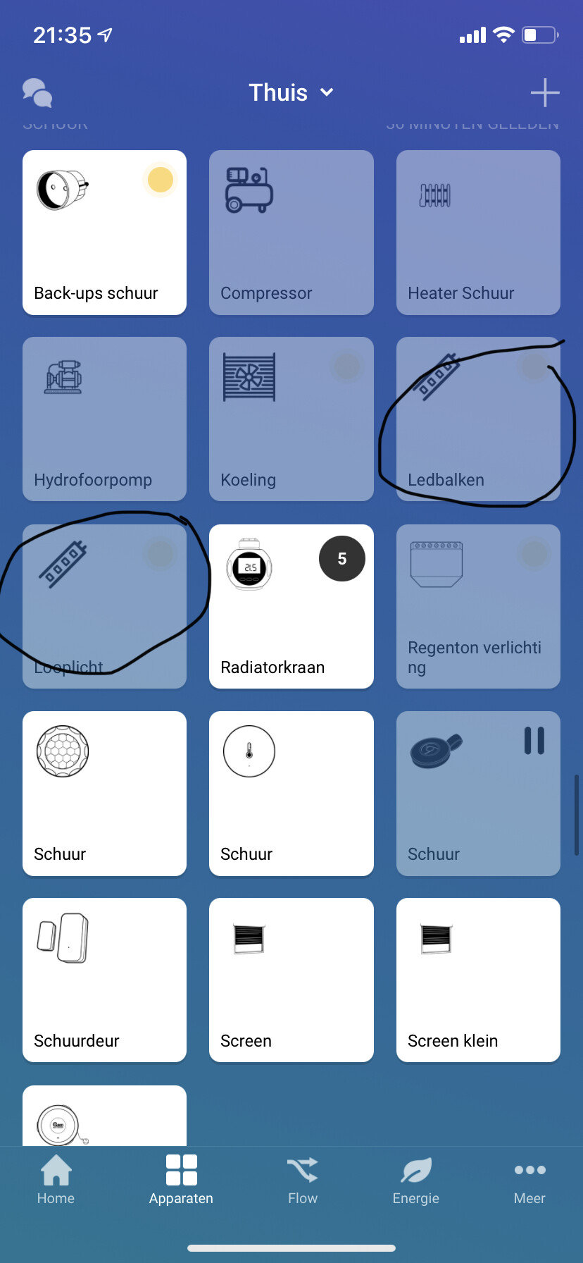

what has changed in the shelly 2.5 confrigration i am using a shelly2.5 for to
Running light in shed can be switched on with motion sensor and when it comes on, the LED bars can be switched on, but now the running lamp jumps, but not the LED bars, but the buttons in homey also go
not on this has always worked perfectly until the update yesterday what do i do to get it working again?
Iâm guessing you need to update your flows as there where some breaking changes in the flow cards. Also have a look at the changelog of 3.0.18 which will tell you what changed.
After you have done both and you still cant get it to work share your flows here so I can take a look at it.
