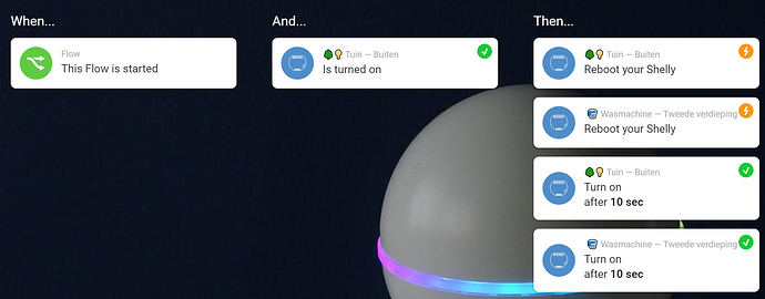

@Phuturist quick question about rebooting the shelly.
They don’t actually reboot. I opened up a CMD window and started a ping, but it keeps replying. When I do the reboot from the Shelly app, it gets a couple of timeouts. Furthermore, when rebooting form the app of shelly it always ends up in ‘off’ position. With the flow it stays on. Gives me the impression it doesn’t actually reboot.
Just noticed this earlier this evening myself. Have submitted a fix which is pending approval already.

v1.20.1 - 2020-05-14
- Fix for reboot action card
- Small improvement for setting callback URL’s (appearently the Shelly needs a reboot for these to become active).
