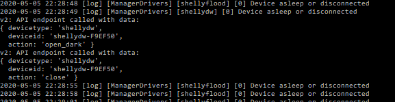

I was using the right version and am also now using the right version (v2).
But I don’t think it gives you the output you are expecting. 2020-05-05_2229
Not expecting but that did pinpoint the problem. I just pushed a change to the debug branch. Could you try again.

Screenshot 1: Output with door open for 5-10 seconds. Flows are triggered as normal.
Screenshot 1: Door open and close in a few seconds. Flows are not triggered. But the new flow with the ‘Actie knop’ is triggered, showing that the tag ‘Actie’ contains the value ‘close’. The batchjob then keeps on repeating the failed attempt. Looks like it is trying to reach the wrong device in the app (rollershutter)???

The log is showing all the right logging including updating the alarm contact when there is an open event. It’s not updating the alarm contact when there is a close event. I’ll have to look into that.
The log showing the rollershutter is something else. Appearantly you also have a Shelly 2 paired as rollershutter which is currently not reachable on the given IP address.
I cant really explain why it’s not updating the alarm_contact capability on a close event. I have changed the debug code around a bit which might tell me more. Could you give it another try by downloading the latest debug branch.
Tried it and it seems to work. Tested it 3 times by opening and closing the door immediately. :+1:
