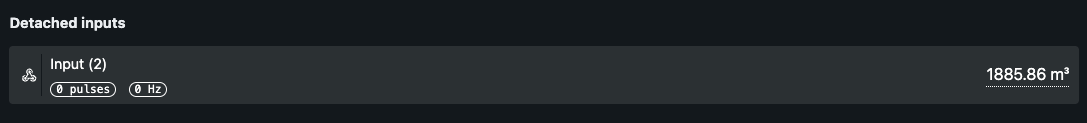

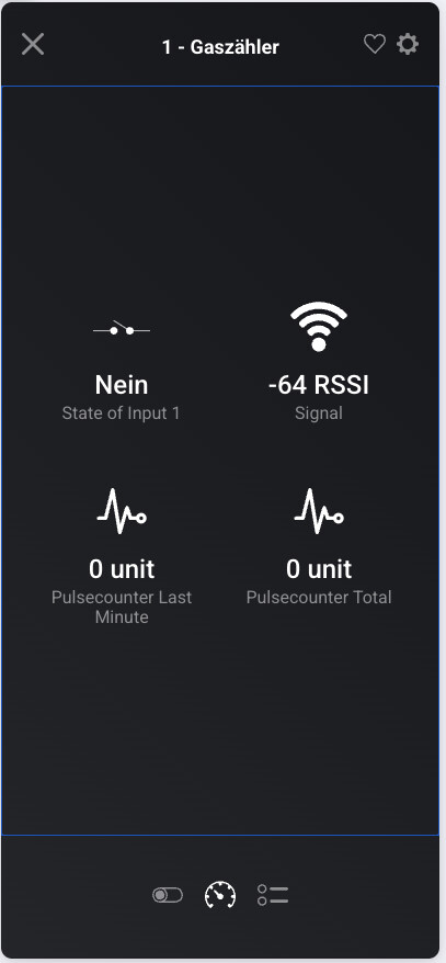

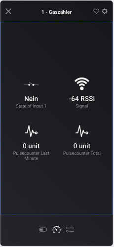

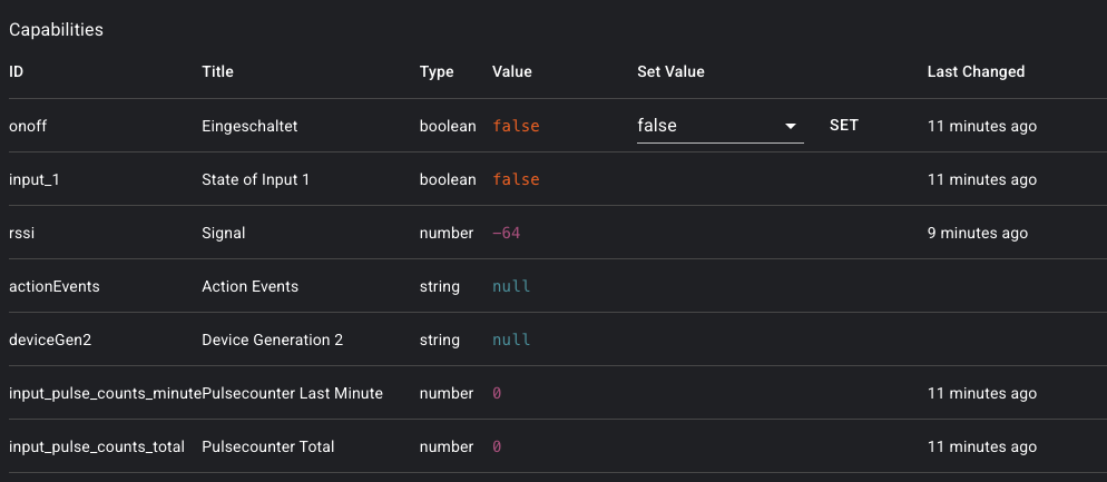

I have a Shelly UNI connected to a Cyble sensor on my gas meter. The Shelly is configured to count in cubic meters (m³), and everything appears to be working correctly in the Shelly UI.
When i add the device to my Homey pro, i get this:
I dont see any measurement..
capabilities looks like this:
What do i have to do to simply read my already calculated gas volume?
The pictures show different inputs 1 and 2?
Pulscounter total is the right one, but, i already configured kubicmeters incl. calculation on the shelly, so why cant i simply consume the value which my shelly is showing?
Im also not interrested in all these clutter the Shelly uni brings with it, i only want to see the counter, but in the right format and not pulses. I would like to show it es a gas meter.
EDIT
I solved it by using MQTT Hub and publishing the calculated value to MQTT by using this script on my Shelly Uni:
// Shelly Plus Script: extrahiere xtotal aus JSON und republiziere als Float
let INPUT_TOPIC = "shellyplusuni-gas/status/input:2";
let OUTPUT_TOPIC = "shellyplusuni-gas/gasmeter/m3";
MQTT.subscribe(INPUT_TOPIC, function (topic, message) {
  try {
    let data = JSON.parse(message);
    let value = data.counts.xtotal;
    if (typeof value === "number") {
      MQTT.publish(OUTPUT_TOPIC, value.toFixed(3), 1, false);
  } catch (e) {
    print("Parsing failed: " + e.message);
In the MQTT Broker i use this topic:
  "meter_gas": {
    "capability": "meter_gas",
    "stateTopic": "shellyplusuni-gas/gasmeter/m3",
    "displayName": "Gas meter"
Finally got what i was searching for:

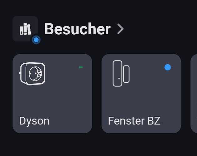

I paired two Shelly BLU Door/Window with Homey yesterday.
In the Android app, the alarm only appears once you’ve logged into the device (long press):
In the web app, the alarm appears immediately:

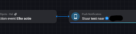

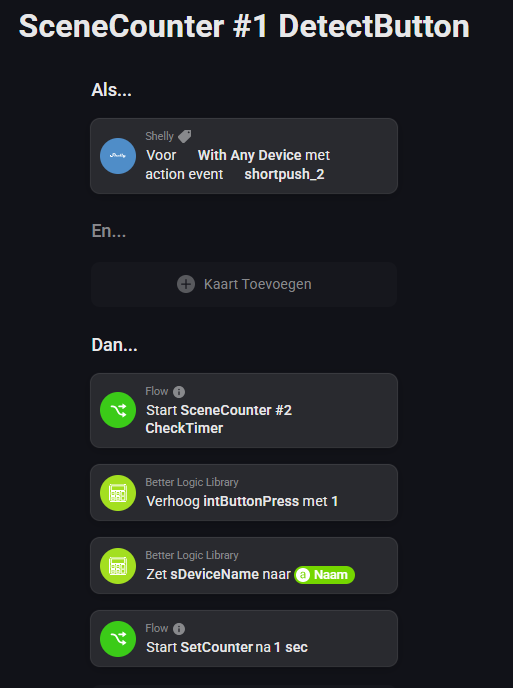

I’m having issues with the Action_Event card. In earlier days, this was a generic card that reported the device and action. Using that I created a few simple flows that count the number of times a button is pressed, and identifies which devices was used. Then a specific flows is started, depending on the action, the device and the number of times pushed.
I use this to select scenes on different buttons in the house, and it does not need anything extra when I new device was introduced since the generic flowcard automatically included new devices.
In the last 3 weeks I had 4 (!!!) Shelly dimmers die on me, so I needed to replace them. Apparently, while the old action_event card is still available (for backwards compatibility I guess) in existing flow’s, it seems it does not respond to newly added devices.
So now I’m trying to build a (as generic as possible) counter using the new Action_event card, but I don’t get it:
This device is a Shelly Dimmer 2. At some point I had this working for S1 and S2 (S1 switches lights, I want to use S2 for scene selection)
Now, I’m not getting any response?

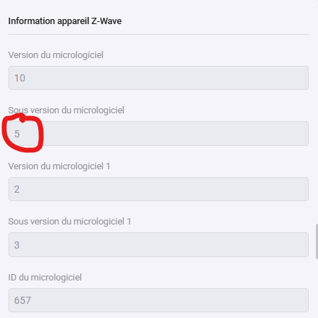

I have shelly wave pro 3.
I noticed that after each automated upgrade of Shelly App, the Shelly wave pro 3 is switched off.
Anyone experienced this issue ?
What is strange is that I have a second shelly wave pro 3 and it is not impacted by this. All the parameters are the same.
Thanks a lot
Is the firmware of the two Shellys identical?
Thanks Asterix for your response.
Indeed the firmware subversion is 5 for one (the one which has pb) and 6 for the other one…
thanks for your advice
You can update it like this if you want…
