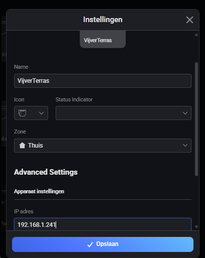

I am trying to use a Shelly dimmer, connected to the range extender of a Shelly RGBW plus. This works when I browse to the Dimmer on it’s IP, and I was also able to (manually) add the dimmer to Shelly using the IP:port (http://192.168.1.241:13378/)
But it stops working (in Homey) after a short while; it seems that the port is lost from the settings:
When I add the port to the IP-adres here it works again, but after a few seconds (or whatever trigger) it stops working again and when I go back to the settings the port has disappeared.

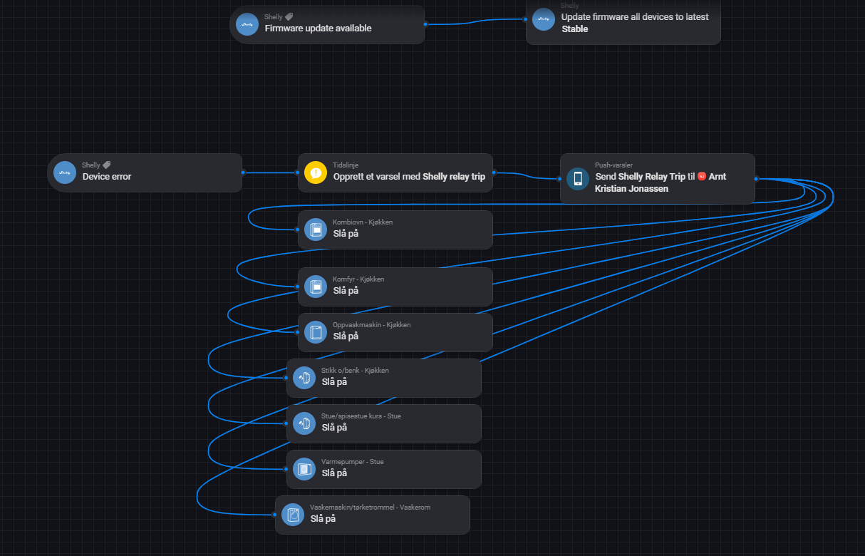

This should do the trick?
On the "device error " trigger you have two tags from where you can easily know on which device the error occurred and what the reason was. Anyway, what do you want to do when you will get this notification?
The firmware update restarts the device. How the relay behaves after this is set within the “power on default” settings. This setting also applies to all restarts of the Selly device for any reason.
Yes looks good. Only question the “shelly relay trip” is that the variable this flow suggests?
Like when you select that timeline card does it say “local tag” device or failure?
