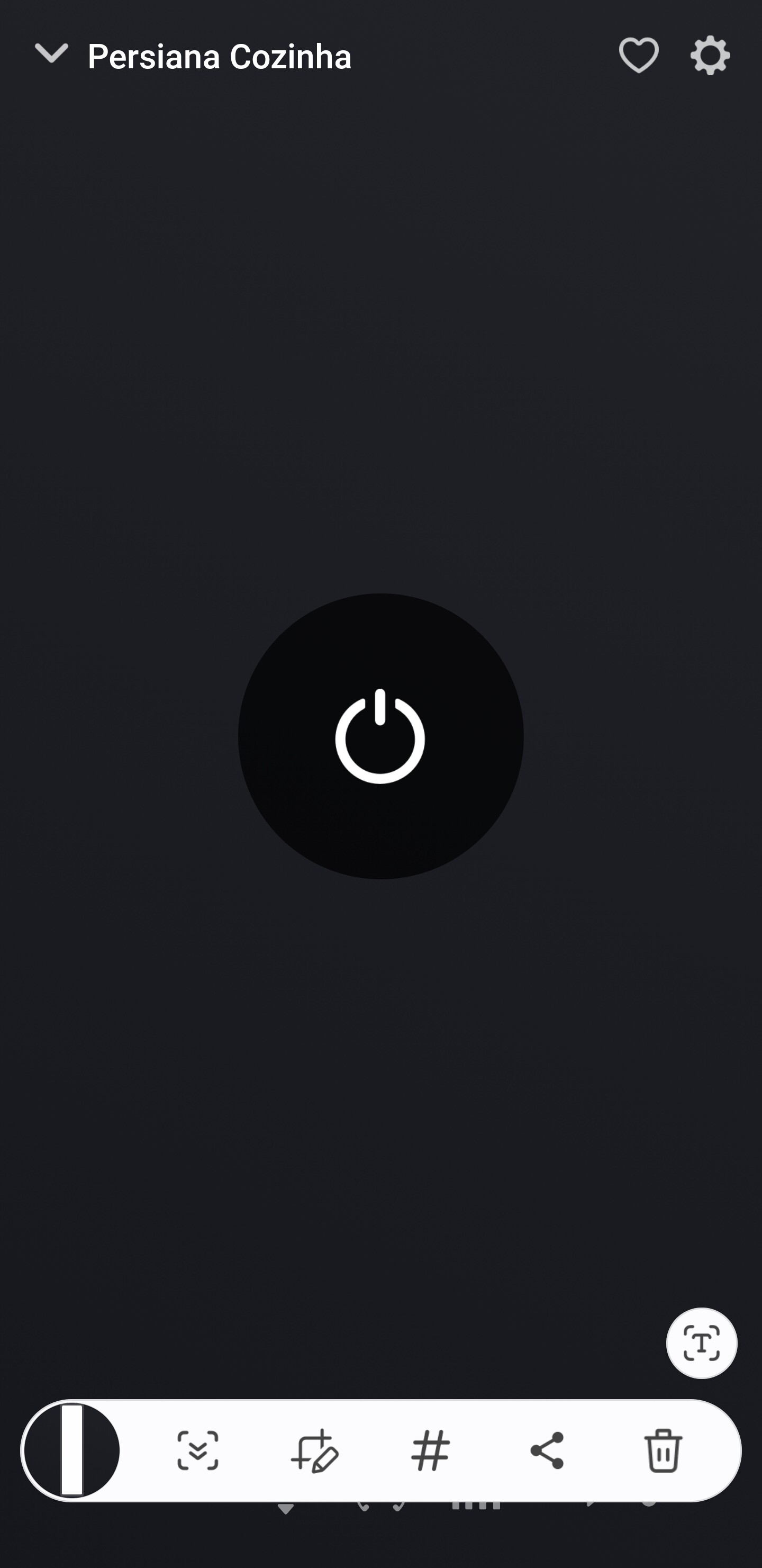

I’ve just changed from homey 2019 to 2023, and now my Shelly 2.5’s (blinds) show a power button, is there any way to remove this without having to add the devices again?
Thanks

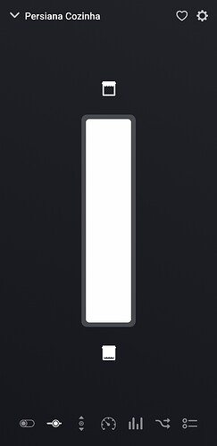

I use a shelly 2.5 for a roller shutter motor.
But sometimes it’s unavailable and ‘dark grey’.
This means switched off, a position that may not occur I think?
How to solve this?

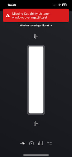

I installed 13 Shelly wave shutters and changed the settings to venetian mode to enable tilt option. Problem is that after a day or two, I get eror message “Missing capability listener: windowcoverings_tilt_set” when trying to control tilt of venetian blinds. If I change settings to Shutter mode and than back to venetian mode, it starts working properly again.
Controling the blinds works ok using the buttons, but not with an app or a flow.
It’s a bug in the app. You should report it to the developer.
Contact details are mostly available in the app store page. Many apps have a support thread.
