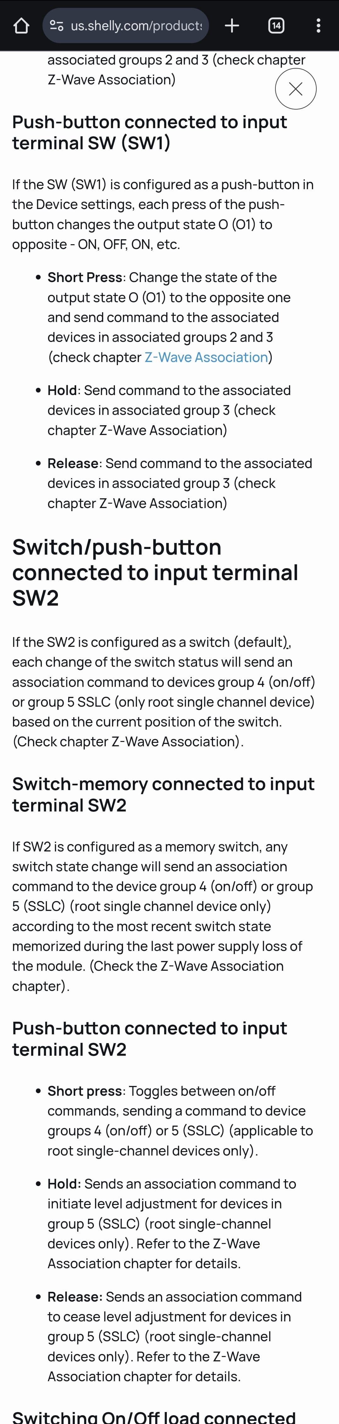

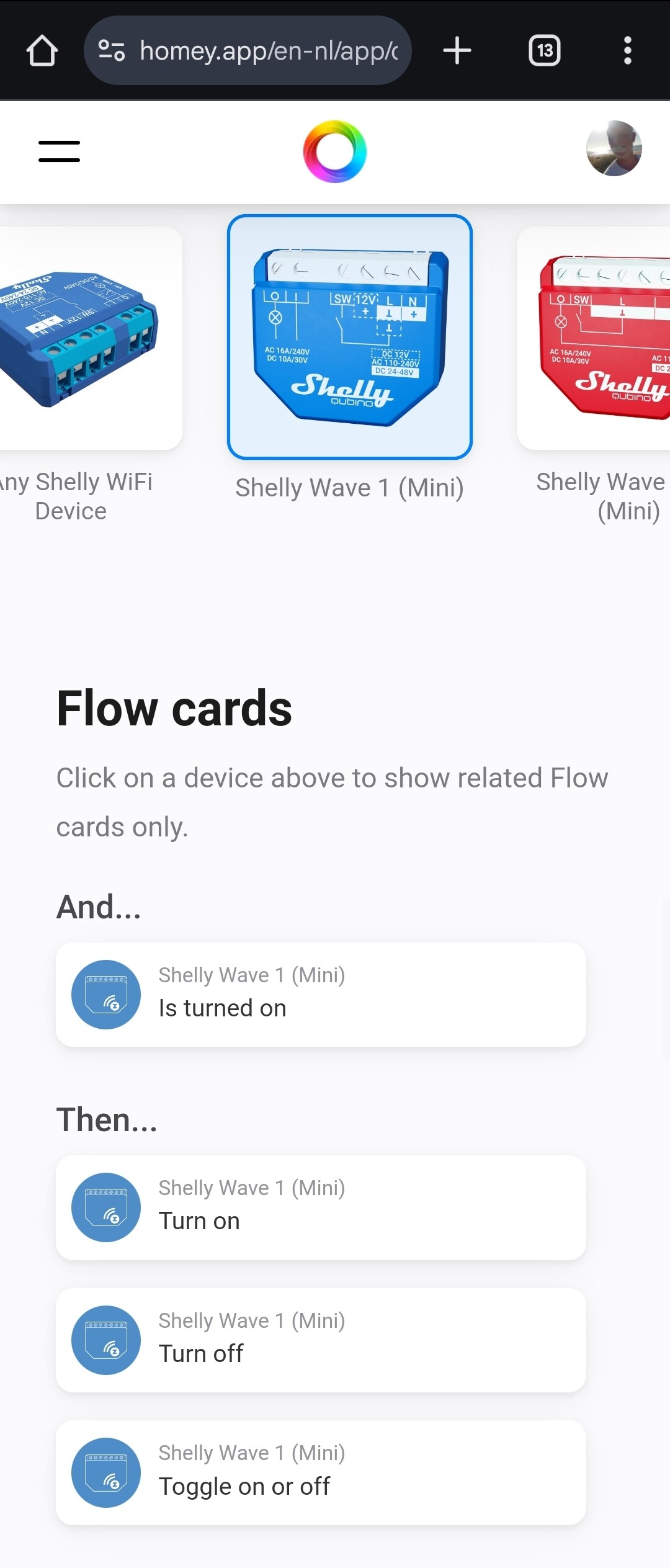

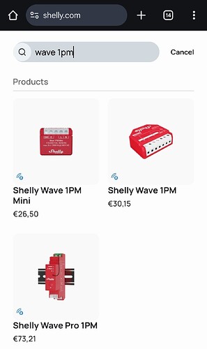

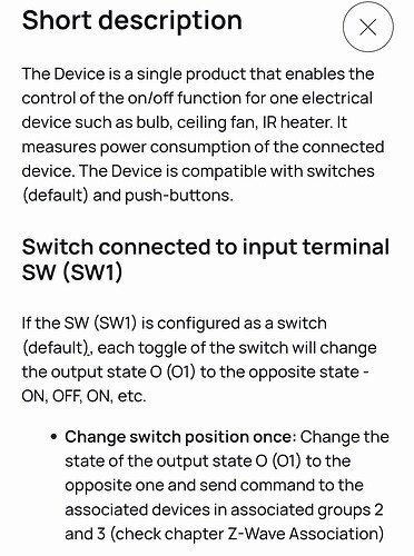

How can i make a flow in homey using long press on the Shelly wave 1 pro? This event is not in homey flows
It’s a switch module, not a wall remote?
I can’t discover longpress functionality
Corrected my question. Was about the Shelly Wave 1 pro
The Shelly model naming is horrible eheh :face_with_peeking_eye:
The Wave Pro 1 indeed has more possibilities.
You’d request for those additional functions with the app maintainer:
“How to contact them info” is mentioned here:
https://community.homey.app/t/app-pro-cloud-shelly/765
And at the lowest section of the homey.app store Shelly app page as well (‘Support: contact link’)
Hint:
And/or try to find out the appropriate z-wave RAW commands for the additional switching functionality.
