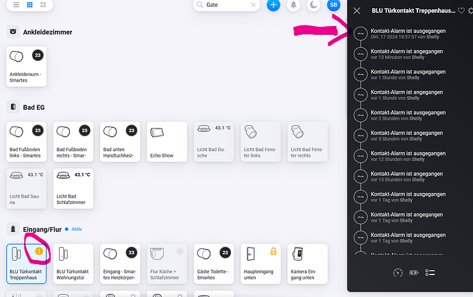

I’ll continue with your instructions straight away. But look what I noticed in the history, the device reported at 7:37 p.m. that the sensor was closed. Here in the ad on the left at 7.45 p.m. still open… strange, right?
another question. i have just noticed that although i have only selected the BLU Gateway in Shelly as the only gateway with an installed script for 1 week, the BLU Sensor 1 connects to a device ā€œlight cooking islandā€ that was previously used as a gateway. But the hook has been out for a week now! what could be the reason?
@Phuturist Hello, I really have tried everything! Everything with my skills! As requested, I am now attaching all the documents and reports with the request that you take a look! Please note that the BLU door sensor that I’m talking about in particular remained open at the end and was definitely closed! the other times I opened and closed the door several times, the signal arrived late! I have the problem with 2 door sensors and 2 BLU motion sensors. the diagnosis is for the MAC address: 60:ef:ab:4a:76:0e
Please also ask the following question: when I deactivate the bluethooth gateway and restart the device, it is often reactivated afterwards!
