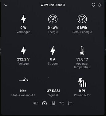

Unfortunately it did not fix the issue: only one of the two switches/channels is available (the one that also includes the WiFi signal strength as sensor).
I also noted that it takes about a full minute for that one channel of the Plus 2PM to become available (red exclamation mark then disappears). Like there is some kind of time-out taking place. While the other devices become available much quicker. Though not as quick as in the current live version (near instantaneously after the Shelly app is installed).
Not sure whether related, but the icon of the WiFi strength sensor is not showing (actually its showing only a little dot in the top left of the sensor):
