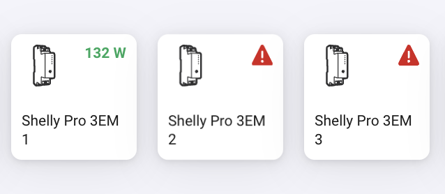

Hi @Phuturist, something went wrong with the new test version (3.32.1) also. From multichannel devices (like Shelly Pro 3EM, Shelly Plus 2 PM) only the main device is available, the attached ‘virtual devices’ are all marked with red triangle, and not available.
Sometimes when adding the device it doesnt add two devices. Remove the device and add it again to make sure it adds two devices (one for each channel).
@Heszi@SunBeech could you test version 3.32.2 which is now available in the test channel? It should now set all channels available upon app initialization.

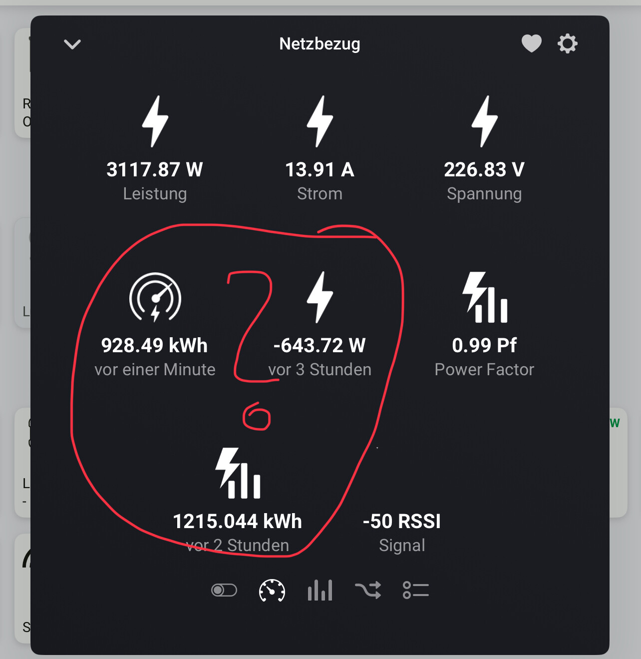

I have some smart Meter shellys (latest firmware) here. Since today’s update the sum calculation no longer works correctly. I have already restarted the app and homey. For example, the value “total power” for all three channels together. can anyone confirm this?

It’s a bug which I’ll fix right away. The release with the fix is pending approval by Athom. You can install the test version if you cant wait for this.
