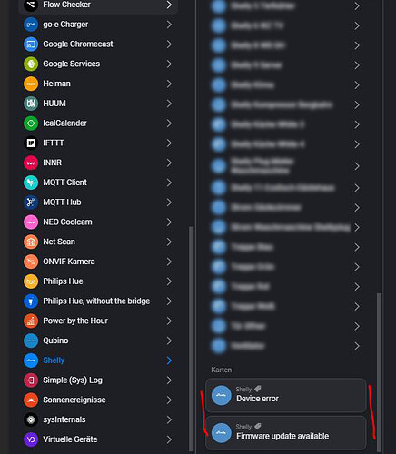

Hihow,
there is no action event card under “shelly-app” like described in the first post. (want to be triggered by input state change). But there aren’t input trigger flow-start-cards or action event for that single device
I have to use capability status app" for this. Any idea? Or what can I do else? :thinking:
Thanx for a verry verry great (and important) homey app! :heart:
Please submit a feature request on Github. This is not very high priority but perhaps when I have some more time I can take a look at it.
Homey does not allow to rename capabilities. Not much I can do about I’m afraid.
Either the input triggers cards (on, off and changed) are available under the device when the input is configured as switch or the action event trigger card (with press events) is available under the device. Your first screenshot shows the cards of the app, you should look under the device.
