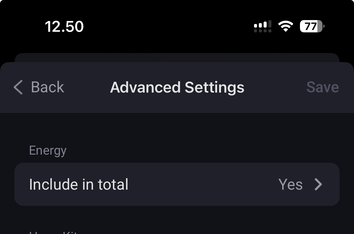

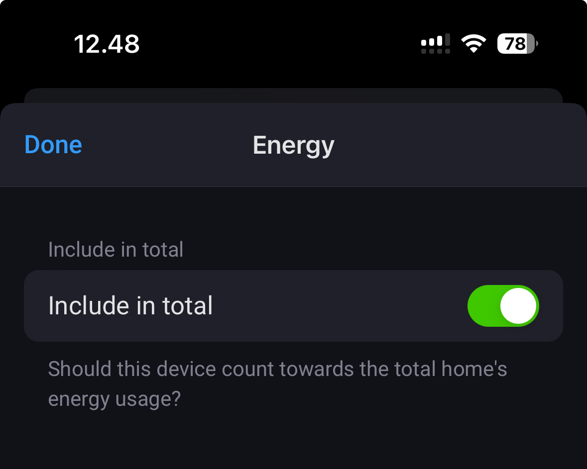

I really think that the device should be configurable for both use cases: single appliance measurements and whole house measurements. I read somewhere in another post that there is some sort of boolean parameter cumulative that can be implemented to the devices. This would then make Homey change its interpretation of the device’s intended usage (to be accumulated to the house energy figures or not)
Obviously if making this user-configurable is not possible, changing the current behaviour is likely to make more harm than benefit. At least I have one Pro 3 EM measuring my EV and another one measuring my water boiler. I wouldn’t like to have two whole house smart meters instead

The cumulative parameter has been implemented already. Each Shelly 3EM channel is added with this parameter to true. There is an action card under the device of each channel to set it to false. It could be you will have to restart the app afterwards. You would ofcourse lose being able to set it for each phase on a single device implementation.

Isn’t it so that this is exactly the setting that controls whether the Pro 3EM is treated as (whole house) smart meter or not? I guess I will need to once more address this with Athom. I will keep you posted.
